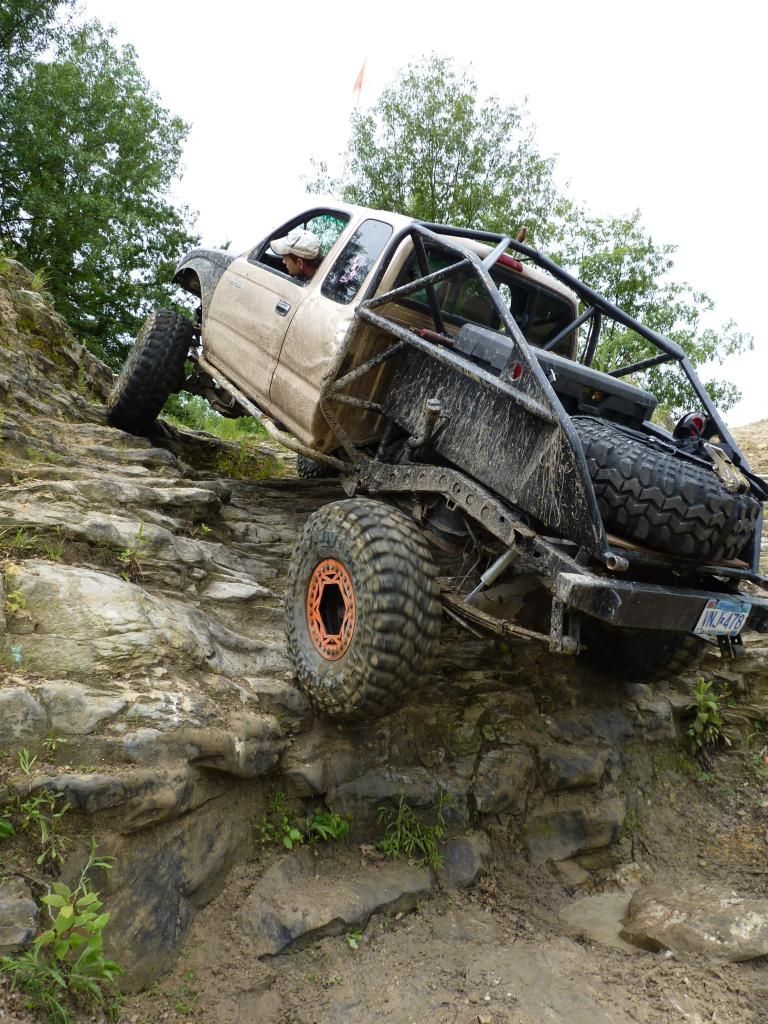

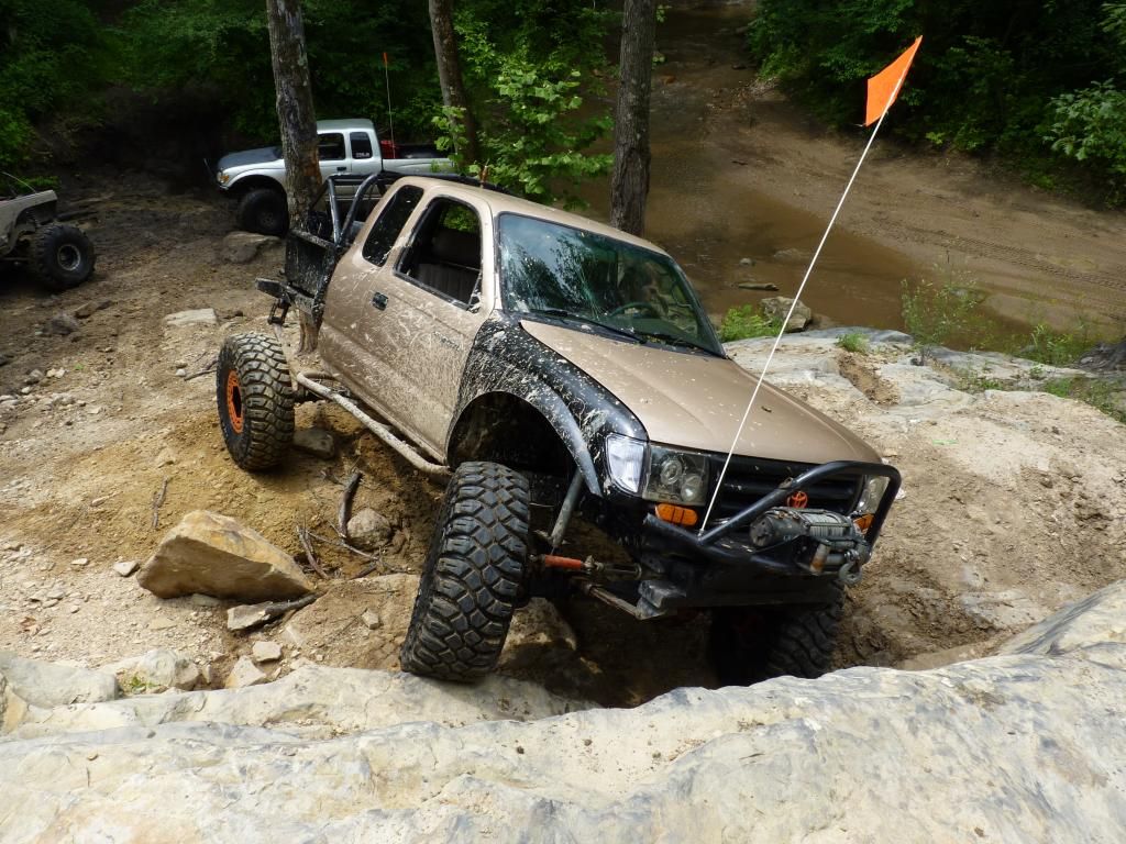

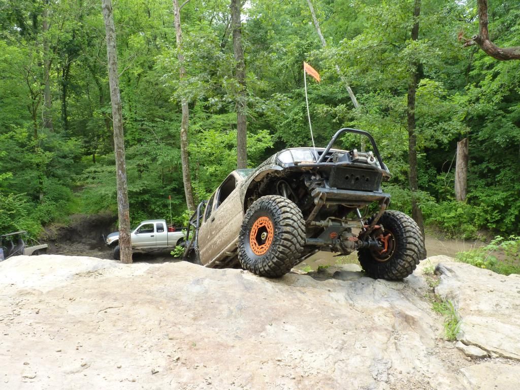

    Pics? Would love to see it

    Whoops. Here:
