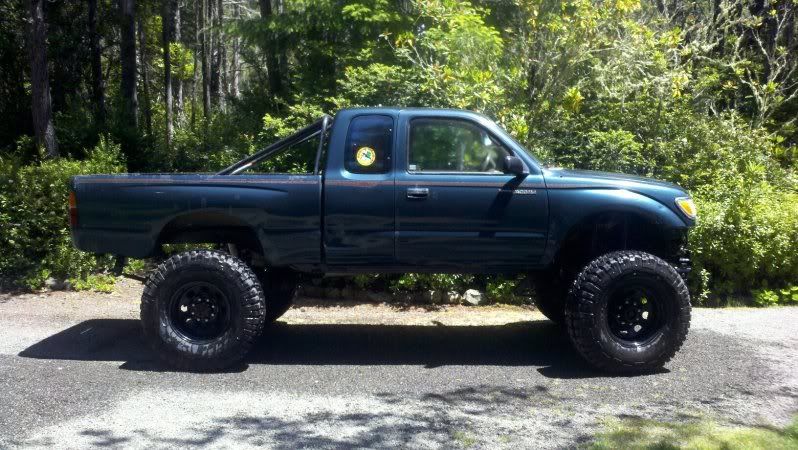

Love my SAS as it makes the truck so much more capable. But I have to admit, Has made off-roading locally a lot less fun :-( Nothing around here is challenging unless I specifically want to roll it over on its side for yucks!
Plus I have so FEEWWWW flex shots, poser or otherwise. Usually end up wheeling in small groups or — GASP! — with just me and my girl and dogs! have yet to get the dogs to understand proper exposure settings & framing. They keep giving me back overexposed garbage shots with half the truck out of frame ;-)

Originally Posted by randombob View Post
Most recent:
Looks great man. Do your tires rub at all on your fenders?

Quote:
Front no rub, rear rubs a touch under full compression. I trimmed away the metal snaggies at the front of the rear wheel well, then hammered what was left -- just enough for the fender flares to bolt up to -- and have pretty much let the tires to gently push out the tight spots over time. Small rub marks on the flares is all I get now.
  Reply With Quote

Note that the rear setup I have moves the centering pin forward so that the tire comes up centered when compressed instead of way to the rear like stock
Most recent:
I really like this rig! It's built right, plus there is just something about about the doublecabs that get the blood pumping
Thanks for the kudos. I'm thrilled with it as well, gets me everywhere I could conceive of going with everyone in tow and all our gear.
Sure there are better "built" rigs out there that can wheel harder... But, none that can DD like mine AND/or get to and from with enough room for 2 peeps, two large dogs and everything we need for a week
