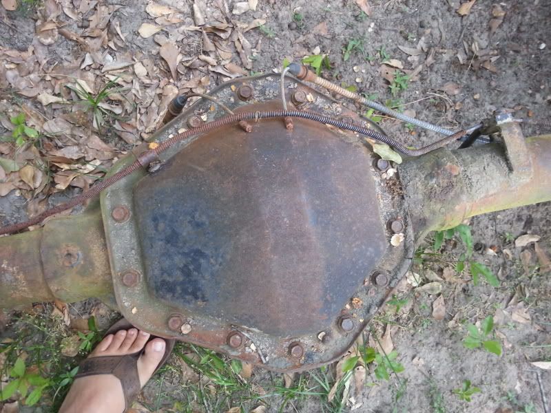

    This Van Width 14bolt has been dropped off to me as a trade. 70" WMS i think
    Its been out in the weather for years.

    That would really depend on what you're going to be "saving" it for...
    For a woods trailer or something of that nature, it's probably fine as it sits. To put it onto a vehicle? That'll depend on what kind of shape the guts are in.

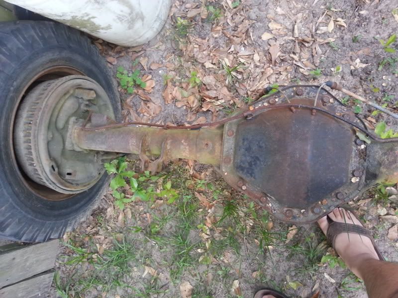

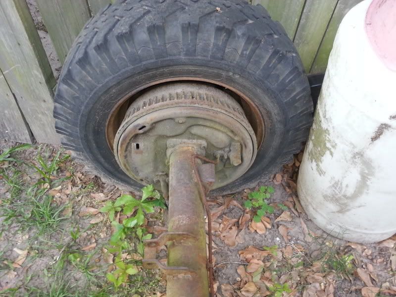

    Well, from the pictures the axle tubes and pumpkin look like they're in decent shape...The backing plates on the drums look ok too...
    But honestly, you're going to have to open her up to be sure. Chipped spiders and Ring gears are replaceable, obviously, but the price adds up if you have to. Same goes for axle shafts themselves. At the very least, if it's been sitting outside for that long, you're probably going to be looking at all new seals and maybe bearings.
    The only way to be sure without knowing the history of it is going to be to clean it up and strip it down, honestly. If you don't do that, it's a coin toss.

    I could be wrong but it looks like a semi-floater. The SF might be stronger than what you have now but a full floater is much stronger.

    Its a FF, Seized shoes on drums how fun....

    Use the bolt trick. There should be a pair of threaded holes in the drums that you can run bolts through. Use Grade 8's; I've had 5's snap before.
    Thread the bolts in until they hit the backing plate, tighten them down (with a ratchet! DO NOT use an airgun!) and then whack around the drum with a deadblow hammer. Repeat. Repeat. You'll be able to tell when the shoes break loose from the drums; after that it's easy.
