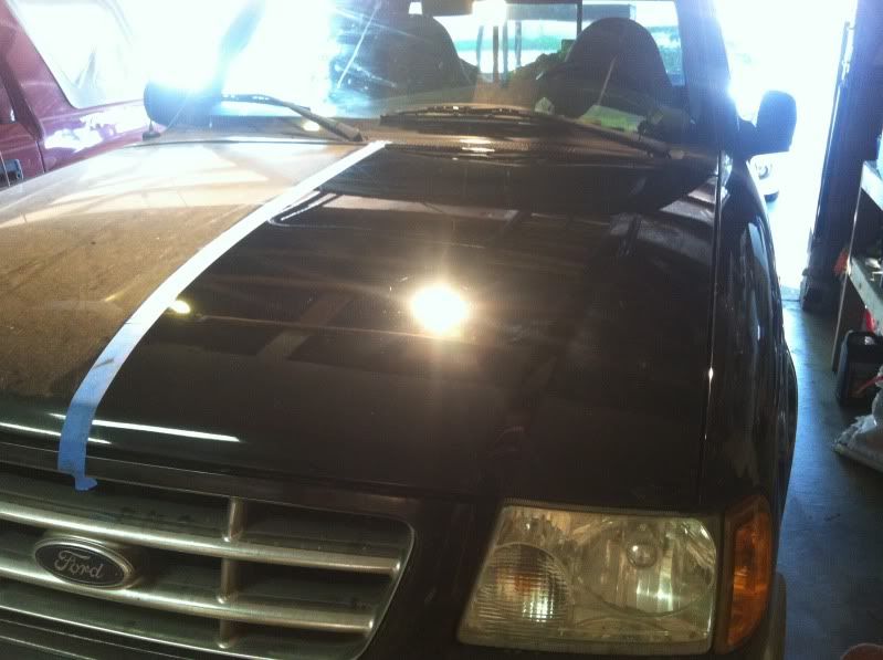

Here is a ford ranger that hasn't seen wax in who knows how long, and i will do a step by step of the correction process.

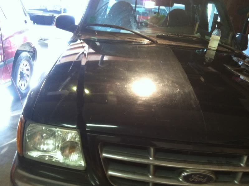

After being washed and clay

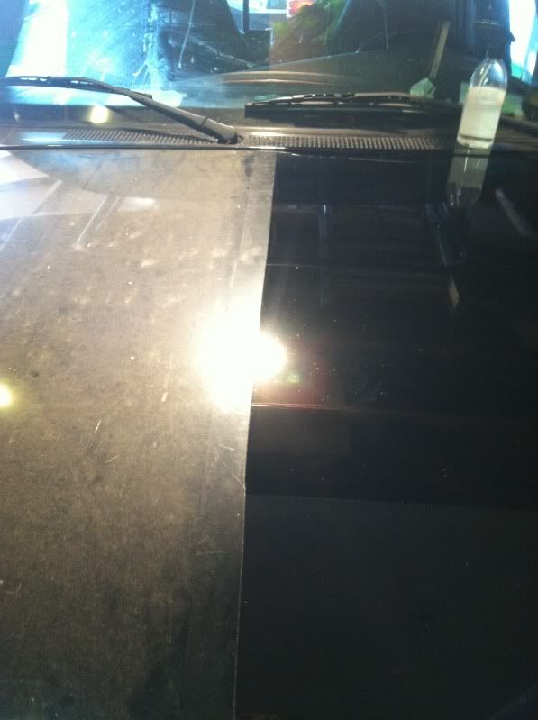

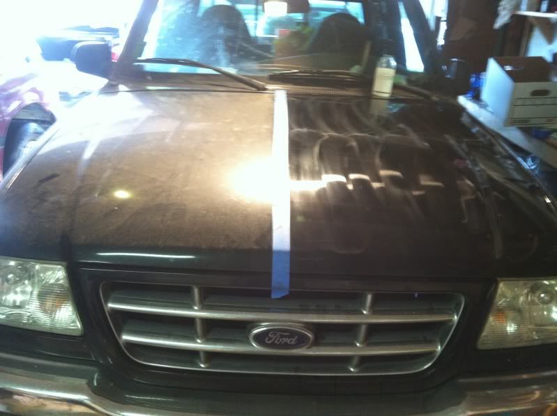

after about 15 minutes with a compound
after compound, before polish so there is haze
the polish steps after compounding to remove hazing and possible holograms..
forgot to take pictures between polish and sealant.
after the polish I did the IPA wipedown to remove polish oils so the sealant and wax will bond to the paint.
after sealant before wax
letting the wax set
all done
