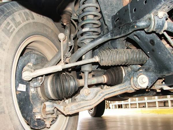

View of suspension from behind front right tire, looking towards the front. Front wheel turned all the way to the left.

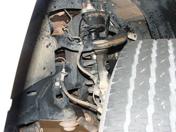

Same view, just from a little higher.

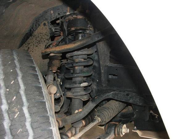

View from in front of front right tire, looking towards rear of truck. Wheel turned all the way to the right.

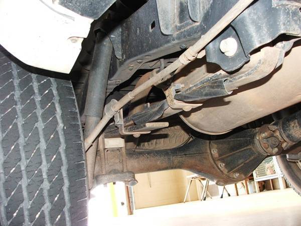

View from in front of right rear tire, looking towards rear of truck. Please ignore the inner-tube in the leaf spring, which I will do right later.

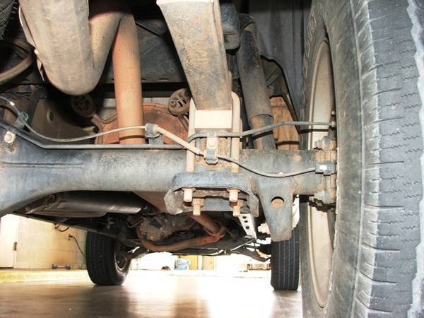

View from behind right rear tire looking towards front of truck.

You have a block in the rear and spacers up front.

about 3" spacers up front and ~2" blocks on the rear.

it looks like u got just a basic 3" spacer lift in the front and a block lift in the back. it lifts a little and levels the truck's rake out. make sure u got front diff drop spacers so as not to damage/tear the cv boots.

Looks to me like an add a leaf in the back and blocks up front considering everything looks stock. I am no genius on this stuff though I will admit.

Whats the oil sprayed around on the front right side from, looks to me like the shock blew as your CV boots on that side look OK

I had an issue with the suspension on that side about 4 months ago, which has been fixed. I don't know if it would still be stained because of that or not. I don't notice any kind of problem with the handling or anything, and the suspension seems equal on both sides.
Could it be something else, or do you think a stain from a few months ago could still be there?

Definitely. You have a 2" leveling coil spacer in the front (not sure what brand makes black, maybe spraypainted..?), and a 1" block in the rear (I got the same one from Toytec a while back, but they all look the same).
So next time you get asked, your answer will be: "2" coil spacer front, 1" block rear"
