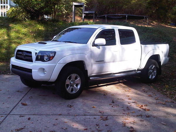

Heres mine @ 1.75 with the tsb, just for comparison. I was gonna go .85 and then changed my mind last minute. Glad I did. It will maintain the factory rake @ .85 and the TSB, and level it @ 1.75. Did all 4 and it rides a ton better than the factory bilsteins.

1st pic looks like factory rake...2nd pic looks nose high...must be camera angles or ground angle?
Nice truck btw.
