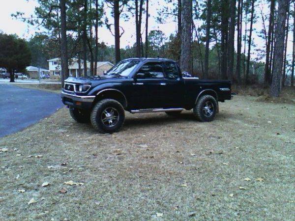

    I installed 2.75" spacers on the front and 3" shackles in the rear. My tacoma is now saggin' in the rear and I was wondering what I can do to lift the rear to get my truck level. I thought about just taking the spacers off, but I'm not sure yet..

    Doesn't look like the shackles did anything for you.

    yeah I know :( why though?

    I will tomorrow. My leafs are pretty much flat though

    my shackles and leafs
    the shocks wouldnt prevent the truck from lifting would they? like if i got longer shocks would my truck lift up?

    3" shackles are only giving you 1.5 inches of lift. You need a 1.5 inch aal or maybe 2".

    Thanks man. so with the AAL, I would keep the 3" shackles on?

    yes!
