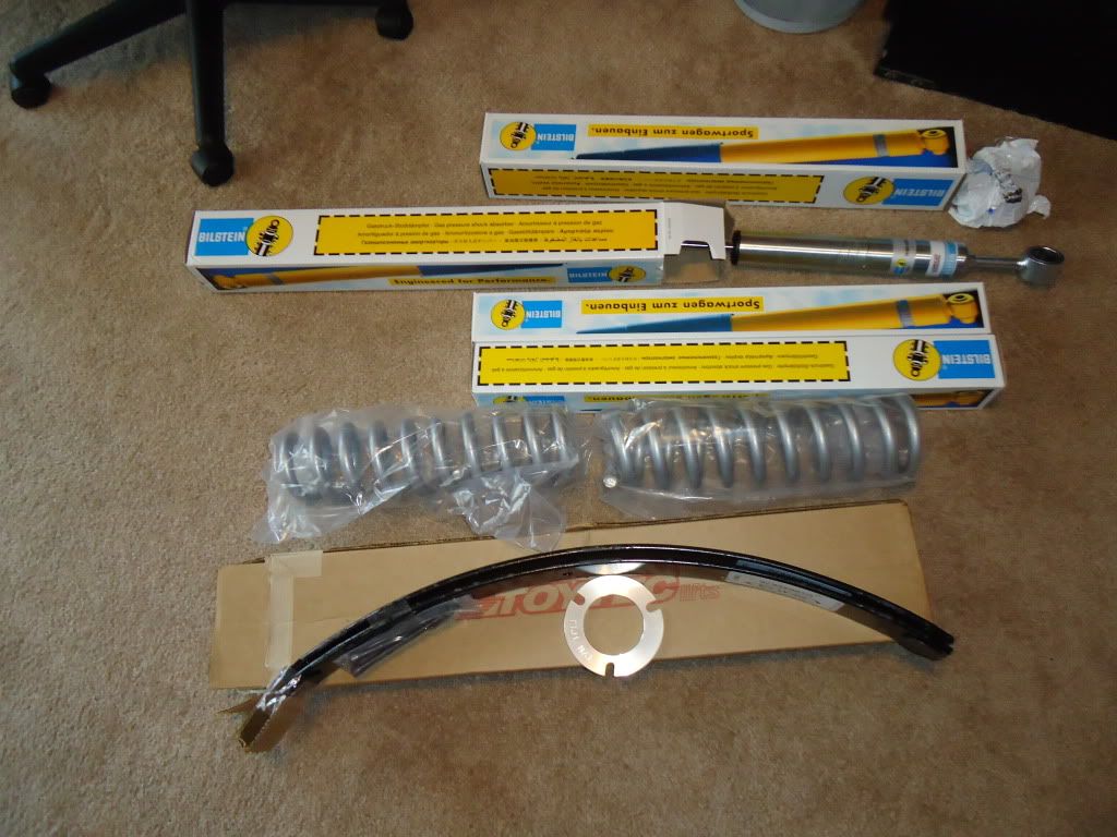

Update w pics: I got a big brown box today =)
After reading for days and days in the suspension section, I finally dove in head first
My set up will be:
5100s all around, fronts set at 1.75
Eibach springs, will give 1.5" lift plus the 5100s w sag = 3" total
2" Toytec AAL
Front Spacer for Toyota lean

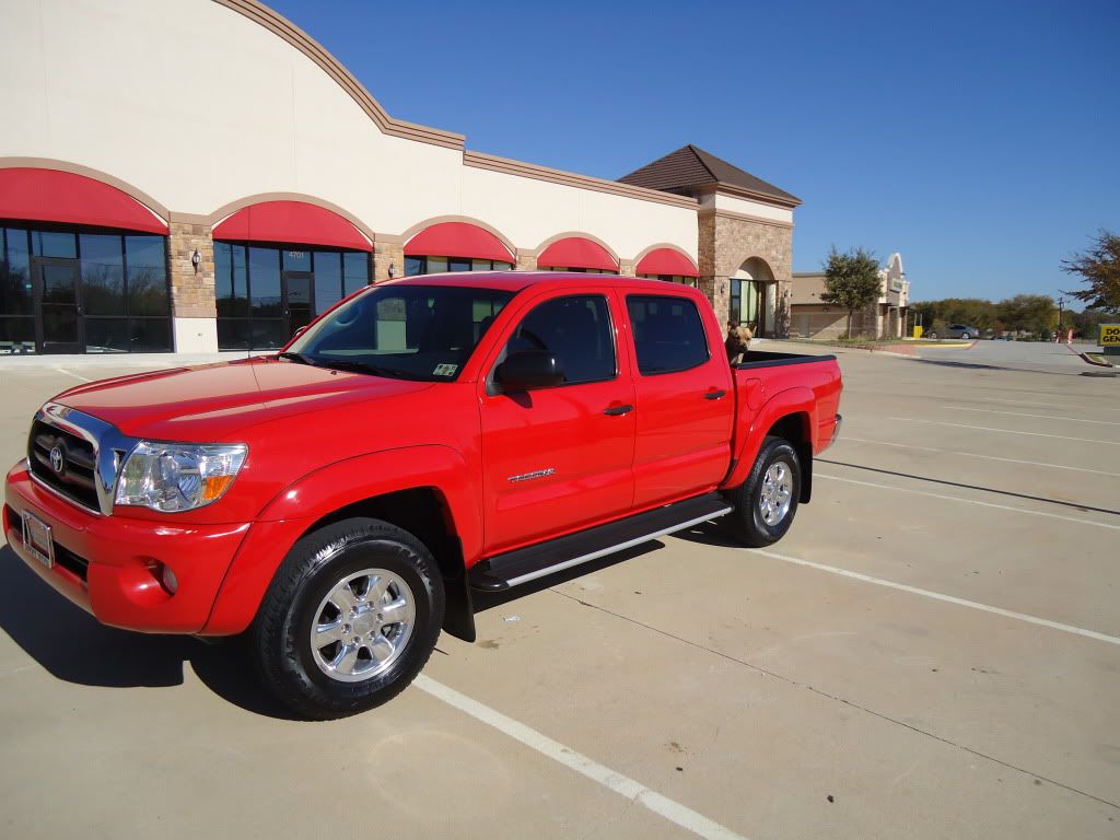

Here is my 2007 Prerunner before the lift
I will start Friday morning and have pics up by friday night. I just moved into my house and newly married, so I do not have all tools.
The tools I will borrow or have are:
2 Jack stands
4ton rolling floor jack
2 6" C Clamps
120 piece craftsman socket set(includes metric and standard)
torque wrench
Rent a spring compress from local auto parts store(or do I even need it?)
hack saw to cut AAL bolt
beer and tacos
Am I missing anything? I will take my time and do it right, make sure everything is torqued and fitted properly
