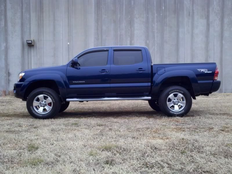

    Thought I might share these pics seeing how lots of guys are doing or thinking of doing this lift option. 5100's all 4 Corners and a 2"AAL. Those are the only mods. Easy install 5 hours total thanks to the great sticky write ups. Chris4X4 I think is the write up guy.

    what did you set the 5100's at in the front?

    2.5 with stock springs.

    I just did this yesterday, so have yet to get it alignment, I can see with my eyes its gonna need it. As for Vibes.... I can kinda feel some at 10mph or so, but im sure once it all settles down and the alignment is done it will go away seeing how weak the vibes are now. The ride feels better than stock at the moment.. I made sure to pay attention to ride feel at stock right before I did the install and first thing I felt for was ride feel during first drive.. Felt good and less jarring IMO.

    Got the 5100's from DownSouth Motorsports... Great Price $283
    and got the 2"AAL from Toytec for $85
    So did this lift for $368 bucks!

    Did you have the rear TSB done previously or did you only have the non-TSB 3 leaf pack? I have the rear TSB done and I'm trying to decide if 2.5" on my 5100s will be even or if I'll be nose high.

    non TSB.. I only had 3 leafs and then added the 2" AAL
