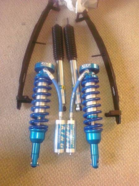

Delivery from DSM!
Can't wait to throw these on!

Can't believe how beefy these things are, it was funny watching my 4yo son trying to pick one of them up.

Icon progressive pack?
If so let me know how they ride and how much lift you get out of them.

Yeah it's the icon pack, I might have to keep the overload leaf in though as I have to use my truck to move hay around sometimes.

Before you install them let me tell you first hand they will not allow full droop and will hold up your axle. We are running pretty much the same set up front and rear and I wish I had gotten longer 5110's for the rear. Just some food for thought before you install and can't return them.
I don't know why everyone on here push's the 5100's
Don't get me wrong mine ride great, but I could use some added travel from a longer shock.
I have been trying to figure this one out too but I guess they are kinda in between sizes on the 5100. Doesn't the same problem exist with longer ones only opposite, meaning bottoming out?
I'm thinking of just getting some OME182's and just forget the whole confusion.

Hey Steve,
That guy I was telling you about, who installed the B110 with TSB + AAL...he called and said they bottomed out.
I set the regular 5100, the longer 5100 and the OME N182 shocks all out on our shipping table, with a tape measure. The OME is about 1" longer than the standard 5100s.
The part numbers for the shocks I compared are:
Top BE5-B110-T5
Middle OME N182
Bottom BE5-C476-H1
Sorry for the crappy picture quality, they're from my BlackBerry.
