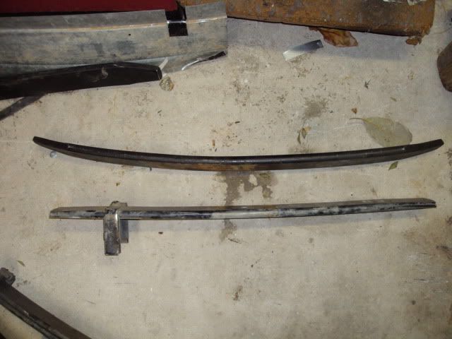

1st gen overloads vs. 2nd gen
It is absolutely amazing the difference is between them....
1st gen. is top ,2nd gen bottom...
A member here with 2nd gen flipped his & got an inch or more of lift, I can't even begin to think what it would be like with flipping a 1st gen. ( DON'T DO IT !!)

This is cause first gens were built better.

Flipping the OL on a first gen useually results in broken springs.

Exactly Chris thats why I don't recommend it & have told others not too..

NO,NO,NO, !!! just rebuilding leafs,the overload stays where it should, this is what i told the guy that DID flip his...
Bro', you had to get more than an inch even with saggy ass springs, the overload alone is right at an inch thick, add to that the degree of arc & I'd say you were closer to 3" <<<<< That brings up an issue maybe, where they make contact under the rest of your leafs, you've probably eliminated a fair amount of any kind of progressive spring rate, those stock leafs being so soft anyway they can't compress normally over the now upturned overload, meaning, if you hit anything that bottoms you out (actually it wouldn't even need to bottom out) those springs & all that energy are going to start to compress & then there going to hit that overload (which isn't going to budge probably) & theres a good chance of either bending or breaking (likely) some leafs.....
I didn't realize the diff in the arc between the 1st & 2nd gens then, but regardless advise against doing it..

Hmm, I was just wondering about this. My OL leaf is arched downwards and I wasn't sure if it's supposed to be like this or if my suspension is really shitting the bucket on me. I already have some backwards rake going on and that's with an ARB up front.

Haha, no shitting the bucket today kRaZy, the over load is arched downward....
