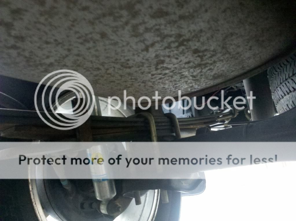

I was in the same boat you were. I put my AAL on and less the 10k I was back to bottoming out. This is what mine looked like with the AAL. You can tell they were shot.
With the AAL a couple of weeks ago.
I decided that I wanted to replace the leaf pack so I won't have to do it in the future. I decided on the Dakar OME leaf pack. As mentioned above it is great. I just put it on last night but have noticed a night a day difference. It is much stiffer but doesn't really change the ride. I no longer bottom out and the ride is much more balanced (the rear suspension seems to match the front better) Here is some picture I took today.
YUP...that's exactly what mine looked like. It seems the AAL holds up pretty well, but the stockers just warp right around them!

Yeah the AAL did as much as it could do, but my factory leafs were garbage. All the strength in the rear leaf pack was coming from the AAL and thats a lot to expect from one leaf. The truck feel like a whole new truck. Everytime I drive it i'm grinning from ear to ear... no more bottoming out.... bring on the bumps...

Neil, thanks for sharing the pics. It looks a lot more even.
