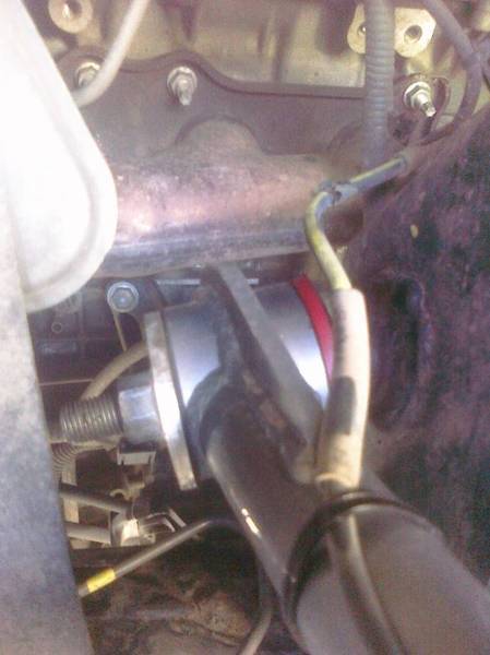

How the Hell did this happen!!
Just got the install done today at Toyota, heard a clunk on the passangers side and look what I found

Am I missing something here? I don't see anything.

Missing bushing.

x2
edit---thank you chris....
take it back to em!

Missing bushing.
Oh. I saw that but I thought that is how it was.

I can't see much on my phone screen , what's the problem ?

Nope. Should have red showing on both sides of the UCA mount.

Well in that case time to go back to the dealer and kick some ass.

make sure the sleeve is in there too.

Crazy thing is I took them in there with the bushings already installed, greased and ready to go....he must of popped one out when he did the install. WTH

You're like a genius or something. Note to self: Idea for a new poll.

wait a sec theres no washer on the inside either

Yeah-That install is an effing train wreck. There should be a machined washer on BOTH sides of the UCA mount and that missing bushing that everyone is talking about.
I'd check both sides and make them replace all the parts- and still buy a torque wrench and make sure it's all on their to spec.

This ^^^

If that's the UCA , why is the bolt so short ? Mine is like 10" long
i was just wondering about that...

Both washers are there, just can't see very well in the pic.....but the bushing What's the quickest way to get replacement set of bushings....I think I will be making a stop at Toyota in the morning

make them get you one they lost it
