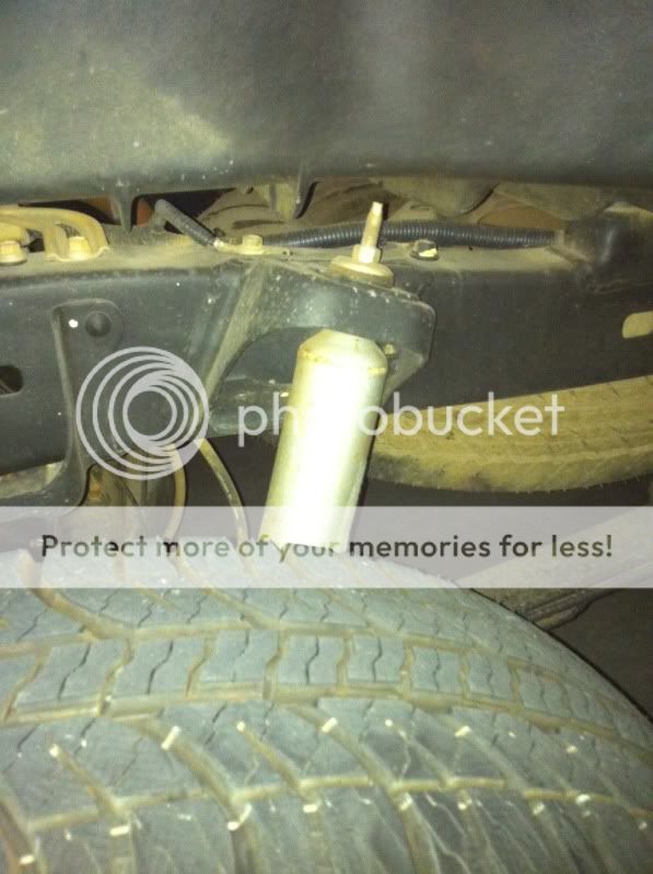

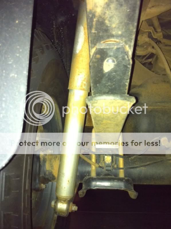

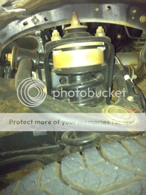

Hi im new to here and i just bought my tacoma yesterday. I am very new to trucks. I was just wondering if someone had an idea of what kind of lift i had and how high it is from stock?
FRONT
REAR
REAR

The front is a combination of a coil spacer and a top plate spacer.
The rear looks to be a small block I think....it's hard to see.
How many leafs do you have in the back?

Looks like the toytec best seller with axle shims

Yeah I couldn't tell if it was a shim or a small block.
What rear shocks are those?

I don't recall Dave's having it on them when I pulled his off, so...........
I'd be inclined to agree with the KYB also.

thanks guys! is this a decent setup?

It's "ok". There are better options out there. Biily's and Eibachs or an OEM set up will give you a better ride.

No not really. It's about the worst type of lift there is actually.
That coil spacer with the stock shocks is going to give you a much harder ride than a nicer setup.
And the top plate spacer allows your lcas to pivot too far down at full droop, which can lead to ball joint damage.

Though it's not recommended by many on the site, as long as you don't do any heavy off roading you will be fine.
I don't see any problems with the rear, the spacers up front are what is mostly frowned upon.
