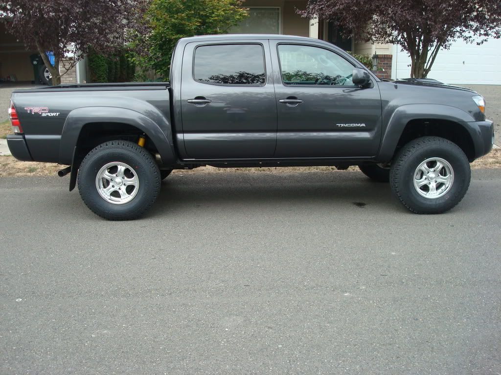

I just installed the Toytec 3" OME lift, using the 885x springs and the spacers recommended in the kit along with a 2" aal in the back. I was hoping for a slight rake, kind of like stock, and imo my truck is level to an ever so slight nose-up stance. Will the front end "settle" at all with this kit? Thanks.

Mine did not settle , remove the spacers or get Dakars
FWIW , it looks level to me
Looks great also

From what i've researched more than likely the REAR will settle... making the already slightly nose high look even more pronounced...

Did you take centre of hub to underside of fender measurements , front and rear ?
I did not.
I am very happy with the driving results, this is just a minor aesthetic change I would like to avoid (nose high). I think I will have to upgrade to new rear leafs in the near future, particularly if the rear settles.

That's how my truck looks (stance wise) you could take the spacers off and it will be about at level.
I didn't pick the spacer option when buying my OME lift and my front end still can clear 285/75/16s with no problems after doing some fender trimming of course.
