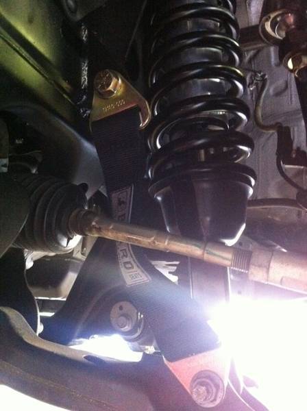

limit straps-stretch?
ok so i know limit straps stretch and i had my installed with an 11" strap, the 11" strap is now 12" and is not preventing the shock to stop at full droop... so i measured eye to eye and look at everything
i need my straps to be at 11.5" AFTER they stretch and everything...
here is how i have them mounted

double up the straps or re-do the mount and use a adjustible clevis and mount

any suggestions on where to get the adj. clevis AND mount?

if you dont have a local offroad shop close by i would order from polyperformance.com they have the best service i have ever gotten from an onine store and they have everything!

As a general rule of thumb straps will stretch an additional 10%.
As everyone else said though, clevis makes for easy adjustment.

so what would be the best way to go about this? weld on clevis to the length of my current strap or weld the clevis were it would best work and measure for strap

no need to measure just use some common sense mock it up real quik and weld it on there, its adjustable for a reason ahha

You will probably need new straps. The clevis itself is pretty long and judging from the pic I don't think you have that much room so you'll need shorter straps.

On a separate note, why are you strapping OEM replacements?
Did you not get the extended travel ICON's?

they are the ext. travel icons

im guessing cheap insurance, i never strapped mine and they were fine and i put those fuckers through hell and back actually i take that back when i rebuilt them the internal limiter was FUBAR..

yes the straps are just because the camburg UCA's come REALLY close to the coils and sometimes hit... but they are the extended trael icons

I have extended travel King OE replacements and at the current preload the uniball cup goes right in between the coils, but if adjusted would most likely hit the coil, so I will be strapping mine as well.
Like Jason said, you have to account for stretch of about 10% and most use clevis' to mount to the frame but they are pricey

yeah, i may go the alternitave as mastercraft makes custom length straps, so idd get 10.5 add 10% and you got 11.55" wich is perfect.... as long as its cheaper than new straps,clevis,mount,labor
