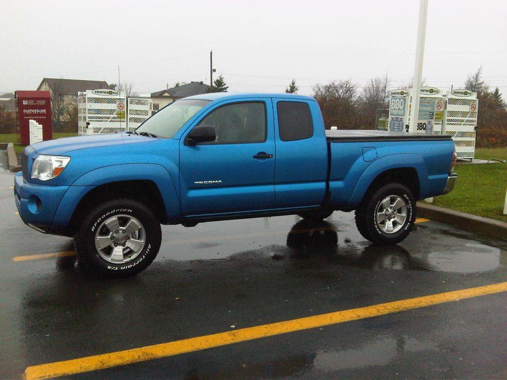

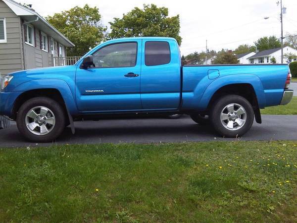

It took me a while to decide on what suspension/lift to get so I want to give as good feed back as possible to anyone wondering.
Put the 5100's on and WOW I cant believe the difference. Unreal feeling in the truck now. Went from the stock Bilstein HD (yellow and blue) to these and it makes the truck feel like a full sized truck because it floats over bumps and the road. I am INSANELY happy with it.
Here is a picture. The tires are 1" bigger, so about 1/2 of lift there and added to the 1.75 in the front its about 2.25" in the front and .5 in the rear. I have the TSB done stock (all canadian Tacos have them) and it sits VERY close to level, with a slight and basically un noticeable rake to the front. Makes it look like a beefy stock look and I love it. Nothing I would change about it. Didnt really hurt my MPG yet either. I lost about 2 mpg with winter gas, and about 1.5-2 with the tires, but nothing since the lift.
BEFORE
without tires
with tires
AFTER
I will post more pictures, but Its raining like a bastard now and I dont wanna get wet. Anyone with questions feel free to ask

You mention the loss of MPG with the larger tires.
Are those the E load range tires 55lbs or the C load range 47lbs.
Trying to figure out how much I am going to loose when I switch tires as well.
I really cannot believe the E range weigh that much for each tire that is crazy.
Stock is about 36-38 pounds depending on what brand tire for standard load rating.

Looks good, my truck is in the shop now but I have a set of 5100s that I am getting installed at 1.75 once I get it back. Need the extra height for tire clearance.
To be honest I haven't had my truck that long and I am not sure what leaf pack I have on the rear. I am assuming it is not the TSB as it is a 2006.
I will eventually add a leaf and 5100s in the rear.

Ya I dont think till this year they came with the 4th leaf. But I will say, you will like the 5100s. My girlfriend noticed a difference right away and she knows nothing. So much smoother

I went with just the C rated ones, but its also the tread pattern that kills the MPG. I like to coast alot to drive it up and these tires have a lot of momentum killing in them. Not TOO bad and I wouldnt change it anyways. Its also noted I went from the stock Bridgestone Dueler 684 II's and IMO they are one of the best MPG friendly tires around.

Nice looking truck. I would have got those C range BFG's but they don't make them in 16 inch.

looks awesome dude! so you just went with the billie 5100's in the front with no new coils, right? I'm about to do the same to mine.. just getting more info.. again, looks GREAT!
