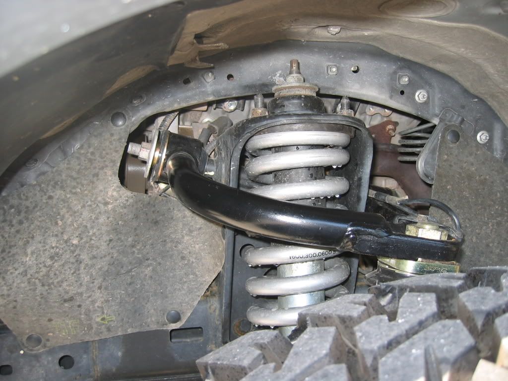

He was looking at my photos and noticed that the shop installed my UCAs wrong and sent me a PM. The little gold bracket under the UCA is supposed to go flat side out. I noticed that the camber on mine was off (toed in at the bottom). If they're in backwards, the alignment won't be right. Took it to the shop and had it done correctly. Now everything looks right.
So put up those build photos folks. You never know what someone might catch.
Mine:
His:

good catch. Thats a good thing to look for when I do mine. I probably would have done the same thing without even noticing.

Damn good eye neubs!

Damn good catch. He needs to poke his head into this thread so I can rep him!
