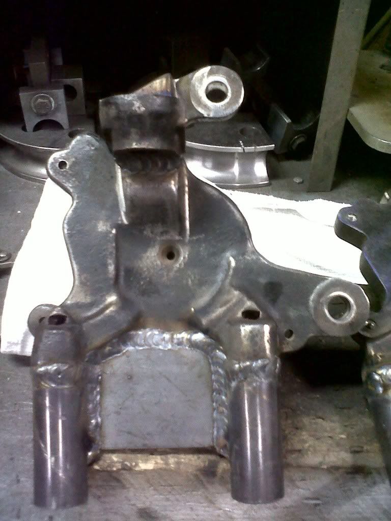

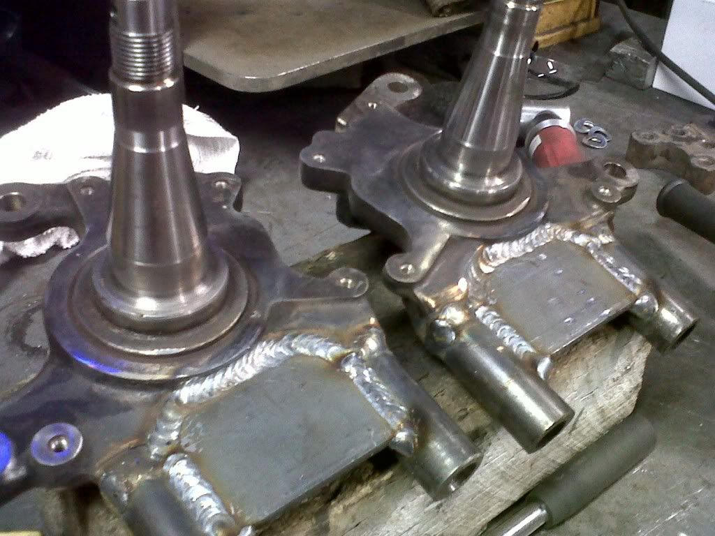

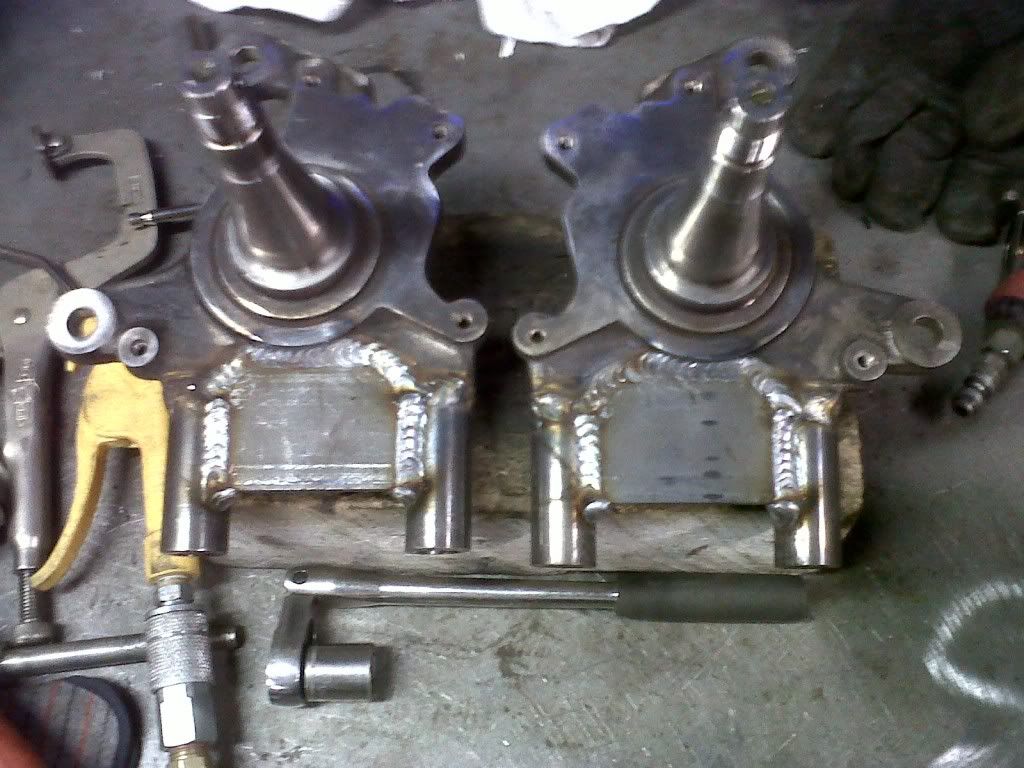

just got these 2.5 inch drop spindles made by catfish. they are bad ass and look indestructible. they keep all correct geometry and stock ball joint. if you have any questions about them send me a pm.

well up to recently they pretty much didnt there were a few shops out there that made spindles for the taco but went wit a unibal ball joint so u had to buy their arms as well these run all stock ball joints. just bolt em on and ur good to go

For a long time I heard your not supposed to weld steel to any kind of pot metal / cast metal. Just what I heard. GLWS

tacoma spindles are made of cast steel not pot metal or cast iron so it makes it ok to weld on as long as u can make penetration and are confident in your welds. heres a couple pics of the truck, ihavnt got the spindles on yet though. its currently laid out on a ball joint flip
