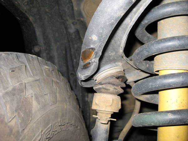

In the middle of installing some new SpiderTrax spacers I found why new uca's are going to be important with a 3" lift. On the passenger side of the truck the spring is in just the right spot, at full suspension drop, to rub the sealed ball joint making the seal split open. Dont know for how long it has been like this but it makes me want/need new uca's sooner then i thought.
What are some of your thoughts about this?

Thats one of the many things I try and tell people when lifting.
yep...........new ones are in order soon man...........the ball joint will lose the grease and rust quick as hell.

Originally Posted by Dark Knight View Post
Do you think a 2.5 or 2" would not let it do that?
2.5 is probably pushing it, close anyway, but i dont think the angle on 2 inches would do that, not for a good while anyway. eventually, it probably would the more the truck is flexed and all.

so, with tc ucas this would never happen? i have the billies set to 2.5...

And you know what he was subjecting his truck to......I dont think I'll be racing my truck through the desert, but if I could I would so good point, forgot all about that. Did he ever say if he replaced them or stuck with allpro?

True, but I've read some not so hot things about them. IMO, I would just spend the extra and get something you never have to worry about. mjp2 went with Total Chaos UCA's. http://www.tacomaworld.com/forum/sus...tml#post268186
Quote from the Total Chaos whats new page.
"The Bitterness of Poor Quality Remains Long after the Sweetness of Low Price is Forgotten"
$150 extra, maybe not a bad thing

I think I'm going the All Pro route for replacements as soon as i can, unless I can get compelling evidence not to.
One of the guys on TTORA ran All pro UCA's for a short while. When I decided to dump my stock UCA's he was ALL over them! He said he would rather have stock, than the All Pro UCA's. He said they were noisy, and rode horrible.

got to looking at funds, and just pulled the trigger on the TC's from down south 10 min ago,

I know it's going to drive/handle alot better but I guess I dont understand how it will ride better

question, i got a 3" toytec spacer kit w/aal do i need uca too? it's not installed yet.

Wouldnt be a bad idea, the pic from post 1 is with a 3" spacer lift.
