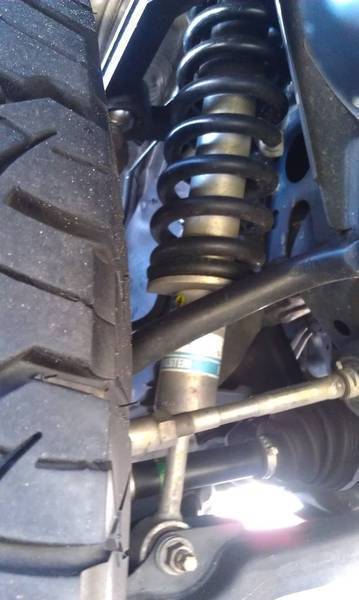

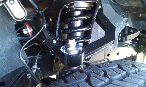

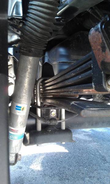

    Was driving down the highway and saw a truck at a local Toyota dealer for sale. I stopped and took some pictures of the suspension and was wondering if you all knew what set-up it was. I know it has the Bilstein 5100's but I don't know what the rest of it is.

    Mesa, AZ
    alot of metal, small engine, decent travel.
    caged, camburg long travel, 50t leafpack (soon to be installed) light rack over cab, 5pt harnesses etc

    22 JLUR 6MT
    I thought those were the DSM UCAs. Maybe I'm wrong.

    2013 Tacoma PreRunner TRD Sport
    is it stock springs in the front?

    Some stuff. Not a lot, just some.
    I think those are DSM UCA's and a wheeler's 3 leaf progressive pack.
    I can't tell. The stock and OME look similar. If there was no pre-load on the spring, then I'd say the were OME.
    what do you mean by preload?
    Looks like the taco lean spacer............and it's in the wrong spot?
    thats what i was wondering.....i didnt know if it was part of the spring

    3" OME lift 885s & Dakars riding on 33" KM2s
    It's the adjustable part of the Billies. You move up the lower spring perch to create lift (and a stiffer ride) by preloading the springs.

    2015 Tacoma TRD OR & 1985 SR5 4Runner
    And it looks like 2 spacers stacked on each other?
    No, looks right to me. All the letters are proper.
    Yeah, that's not good.
    maybe theres spacers on both sides to gain a full 3 inches?
    No, no it's not lol. After looking at it some more there are definitely 2 spacers stacked on top of each other. Well at least he got some of the suspension components right.
    So I take it this is not a good set-up?
    If he didn't stack the spacers then it wouldn't be a bad setup. If you want something similar to what this guy has, check out my build thread. I was very happy with it and handled well on and off road.
