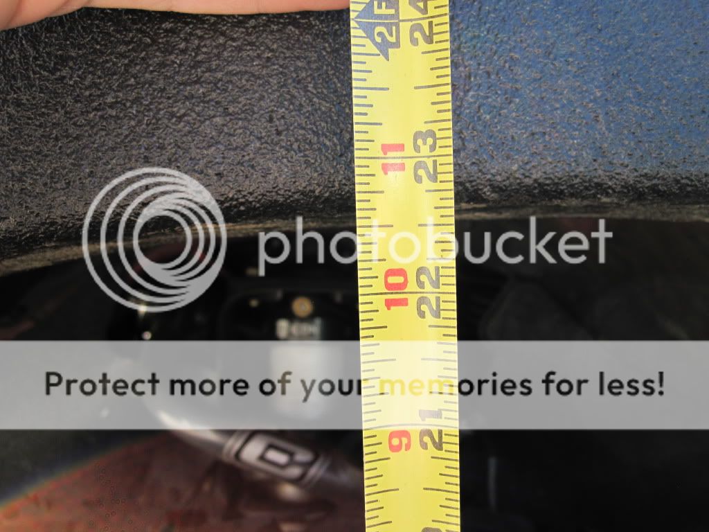

With this preload, here is my lift measured from center of wheel to fender edge:

So I got the bumper and winch installed today. I had to crank on the coilovers a little, but they sill have aBout less than 2" of threads showing. I drove 75 miles today, and I have to say, it is a tad bit stiffer than with the 650lb springs, but still way better than with my 5100s set at 2.5"...I will post some pictures of the threads tomorrow

This is where I am at with the bumper and winch on and measuring 23.5-24" from center hub...

What's the ride like now compared to before and compared to stock?
