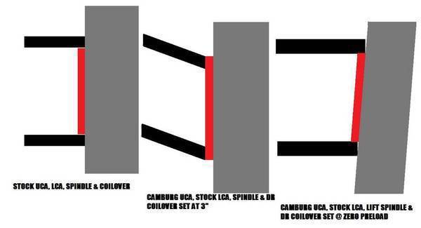

Quick question, And I don't see why I'd have any problems getting it aligned BUT...
Right now I currently have Dr/ICON coilovers (maxed out pretty much) and Camburg UCA's. The plan is to add the spindles and take the coilovers down to NO preload.
Question is: Will I have any issues aligning the front end at all?
Thanks!
Shane
EDIT:
in post #15
"He explained that because the Camburg UCAs are longer, the're designed to compensate for the "droop" that's created when you use coilovers to lift the truck. So when I add the spindles and "lower" the coilovers back to ZERO PRELOAD (stock height), i'll end up with positive camber due to the longer UCAs sitting level instead of pointing downward.
Does that make sense? it does since he went over it again with me LOL So guess now the only way to get what i'm looking for (4" of lift and good alignment) is to go back to stock UCAs or stock length UCAs then install the Spindles... "

^^^ Ok I spoke to my buddy again.. he explained it a little better... I'm guessing the reason why you were able to reach 0 camber was because of your UCAs and them being stock.

Quote:
Originally Posted by allmotorrex View Post
U should end up adding negative camber by lowering the coils and giving u back more adjustment
wouldn't I end up with positive camber due to the longer uppers?

yes

I just called Camburg and they said that the lowest i'd be able to take the coilovers down to would be 1" and that I should still be good to get it aligned... that would still put me up at around 5" of lift.. :/

Quote:
rcfreak has the camburg spindles and camburg uca....he has like zero preload in the front......didnt look like he had mega posotive camber
