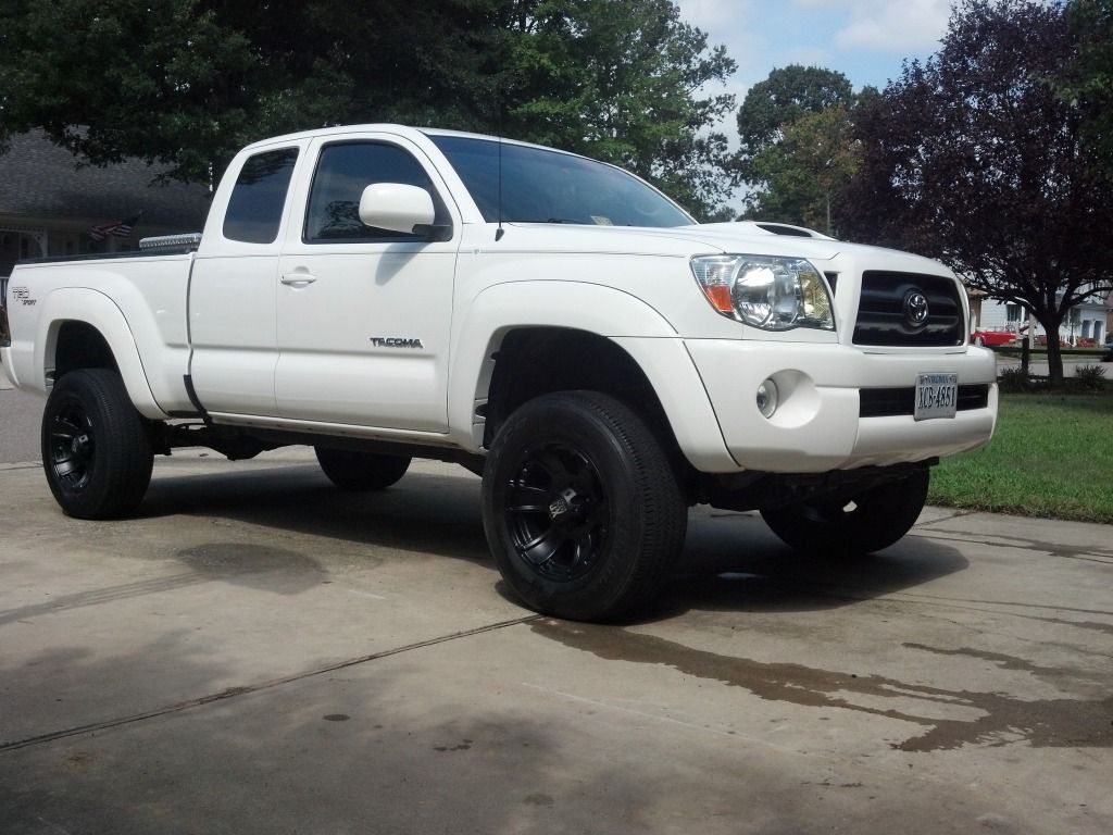

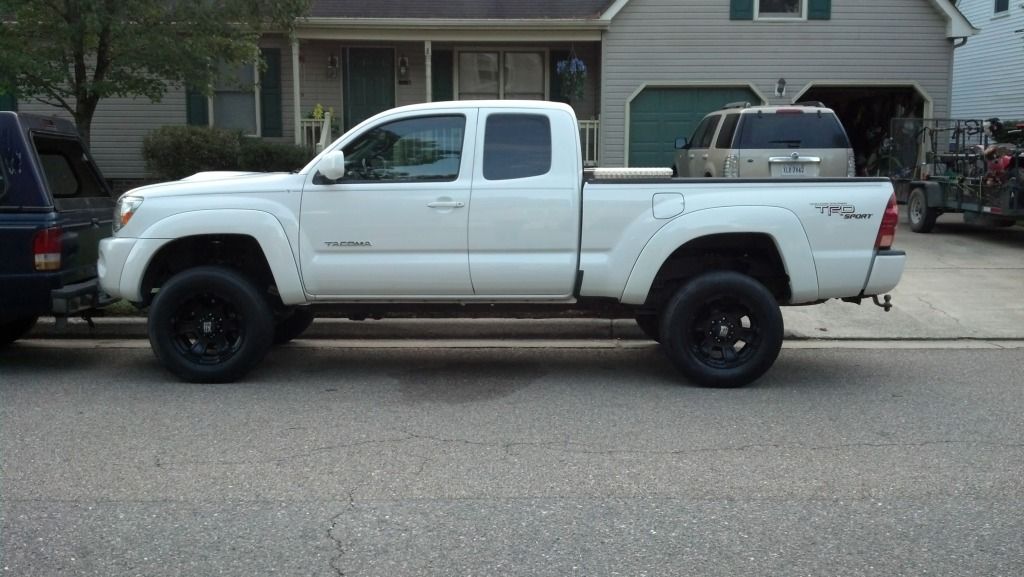

finished doing my lift saturday took about 6 hours.... this is 5100 all around, ome 885x coils, toytec top plate spacer, 2" aal (sense i dont have tsb)
i have stock tires on (for now) with the 17x9 XD Revolvers, will post pictures when the 285s are on at the end of the week
Truck rides better then stock (IMO) completely with every cent!

yeah they are, stock uca, ill do alighnment when i get the 285s on. rear was around 37 inch and front was a little less then 37. did u want exact? and i have no lean

i got 23.5 from center of hub to bottom of fender in the front both sides and 24 inch in the rear
