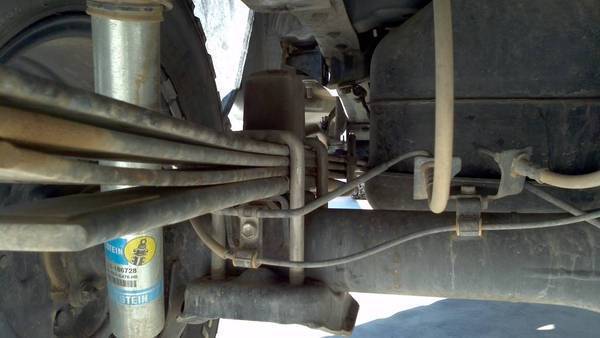

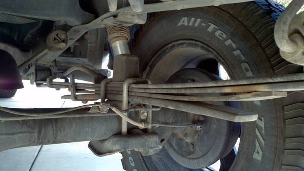

    My leafs are squeaking after a recent trip in the mountains and I know lots of people complain about that, but look at these pictures and tell me whats wrong. I think they are spent, but need your input...thanks in advance. BTW, I did add a Deaver AAL about a year ago to the stock pack.

    they look shot to me. They are almost sitting level i would say get a new pack.

    Wow those are flat. Is your bil bent or is that sleeve just messed up? Id say time for some new springs man

    The AAL is probably causing the squeaking. Mine started to squeak after i installed my AAL.

    yes they are shot. and yes you can the AAL.

    My overloads were almost contacting completely with the aal and the rest of the pack.
    I do have lot's of weight in it so I guess better ones are needed in the future.

    Sleeve/boot is just messed up. Thanks for the input guys. Time to go shopping!

    Looks like you already flipped the stock overload leaf. That's the cause of the squeak. Never should have done that. Should have bit the bullet and installed new leafs.

    ^ the over load spring looks positioned correctly to me :confused:
    I think yer confusing an over load spring with an add a leaf spring.
    But yeah.. those springs look tired.
    Squeaks can normally be associated
    with the springs eye bushings...
    and even the shocks eye bushings.
    lube those up when replacing the springs.
