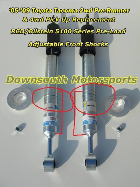

Ok.. I know its a long shot but I am on the search for these certain front shocks that I noticed were slightly different then your standard Bilstein 5100.
As you can see below is your standard Toyota Tacoma 05+ Front adjustable coil over shocks.

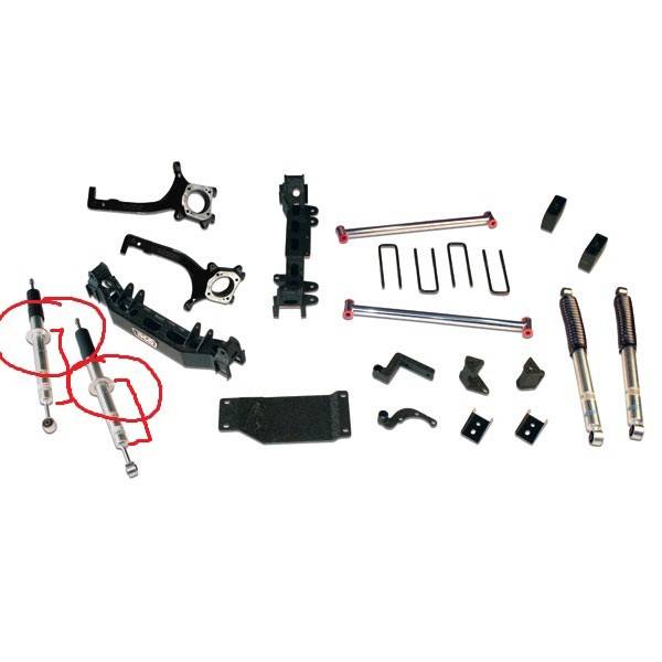

Now look below and in this picture is the 05+ Toyota Tacoma 4" Lift kit from RCD and they seem to offer a different set of 5100's with it...
Now I know this could be a generic picture they use just to represent suspension components but it really doesn't look like it. Is there anyone out there who can enlighten me and tell me where I can get those 5100's?

Why do you want the longer 5100's?
They won't fit without RCD's 4" drop bracket lift.
But, from RCD's install instructions for that lift, here's the old and outdated bilstein part number. F4-BE5-E122-T0
If you need them, call RCD.
