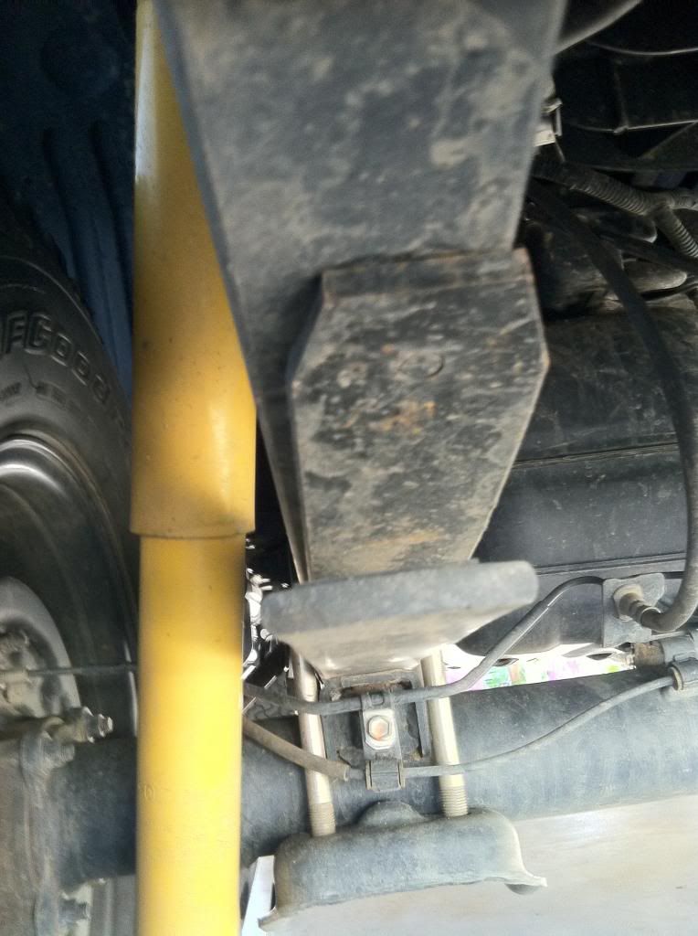

loosen u bolts, whack AAL with rubber mallet, tighten/torque u bolts.

Quote:
Originally Posted by xgalvanxgx View Post
would this ruin my alignment at all?
Nope

How did that happen?
Is something bent?
Whack it--Not familiar w/2009--the 2003 AAL is TIGHT.

not sure really. maybe in the process of installation..

these
you can either loosen the u bolts, or you can find a place to flex that side out
then pound that mofo back in with a rubber mallet.
Ask me how I know
happened to me a bunch of times when I still ran an AAL

haha wow. yeah ill try flexing. sounds more fun.

Old Man Doug make spring retainer clips out of a couple bolts and some flat stock. If this is a concern, you can always make one of those. I went with the 3-leaf AAL, comes with it's own spring retainer

mine would slide out every time I went wheeling, even if I tightened the u-bolts. probably could have used a retainer
but it broke in half anyways haha
