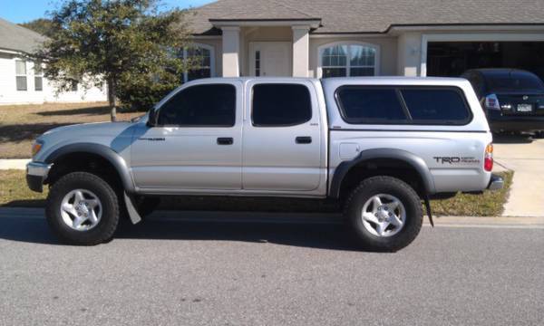

I have a wheelers 3 leaf aal installed in the rear as of right now.. I was trying to level out my truck since it has a camper shell on it. I was thinking about installing wheelers 1.5 inch aal on top of the 3 leaf aal... would that work? Thanks guys!-Swanny...
