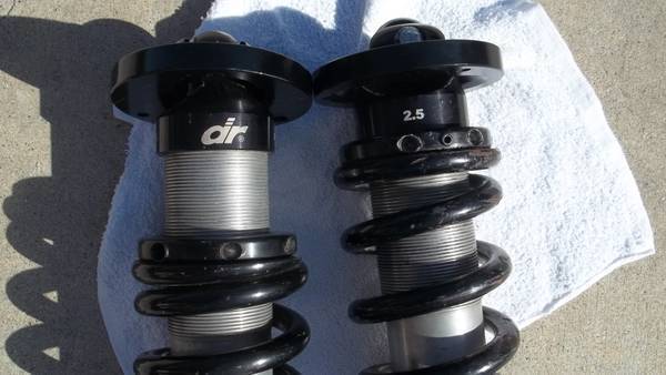

I found a guy selling used Donahoe 2.5" coils for 350 OBO with about 7000 miles on them, they dont look to bad at all. Ive seen people buy them used and rebuild them, its just sketchy buying used coils.
Whats the price for a rebuild?
Should I buy them?
How much to ship them 160 miles?

They look to be in pretty decent shape......I'd send them to Icon for a re-build. They charge $125 a shock and will switch out the DR tops for Icon one's. Hit up the Icon rep in the vendors section and shoot them a PM.

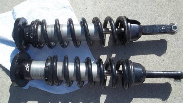

Well, these are adjustable so you can set that at any height you want. They go to 3.5" of lift maximum.
The 2.5" you're buying is the diameter of the shock, not the lift height.
By the looks of the photos, one is set to 0" of lift, the other is around 3" of lift. Not sure why one is cranked down and the other is not.

The 3.5" are prob ext travel which you'll need UCA's for. You can set whatever height you want. Compared to spacers you'll have a boner for a week straight everytime you hit something!
Mine are at 2-2.5" lift w/o sway bar and their buttery goodness!
