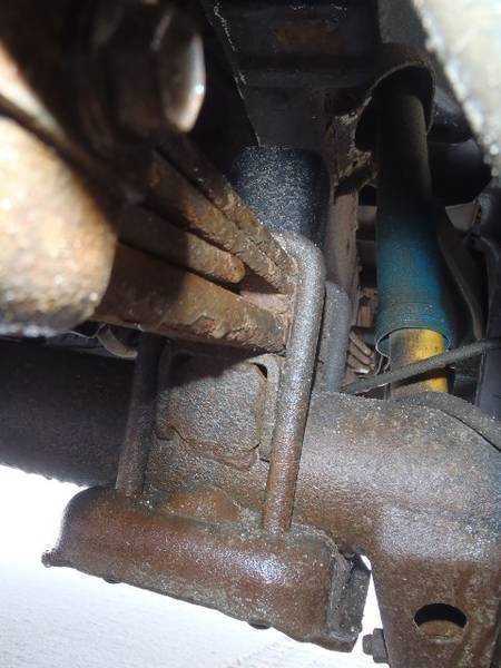

Well I wasn't fully ready to pull the trigger on new suspension components, but a quick look at my truck this afternoon has pushed me over the edge. I have a broken leaf spring on the drivers side. I will be purchasing new leaf packs and placing the order tomorrow. There is no way I'd put Toyota springs back on this thing. The ones that came factory are the canadian 4 leafs and they sagged as soon as I started hauling my quad around.
I'd like the rear to be a little more stiff because I haul a 14ft trailer with quads. As for lift I don't really want it to be more than 1 1/2" - 1 3/4".
Option 1: Dakars with 3rd leaf removed. Can people that have done this chime in on what their center hub to fender measurements are? Or just any info at all would be appreciated, about height gained, settling etc.
Option 2: Wheelers HD leaf spring. Anyone with experience? I searched around and doesn't seem to be that much info on them.
For reference I have a 2007 DCLB SR5 with 200000km. My rear measurements now are 22inches both sides with a little less than 1/4 tank of fuel.
All help is appreciated I'd like to make a more informed purchase tomorrow because I need my truck in a couple weeks, so I'd like to get this stuff ordered ASAP.

Do the Wheelers HD
You will get at least 2 1/2" lift from the Dakars

2 1/2 inches even with the 3rd removed OZ? Not sure if those guys that took it out were running caps or weight in their bed.

You probably get around 2"

Went with Bilstein 5100 on the 4 corners, Wheelers HD leaf pack, stem cushions and new eye bolts for the rear leafs. Will post pics once installed.

Sorry for the crappy cell pics but you get the idea. This is Bilstein 5100's on all 4 corners with the front set at 1.75 with a Wheeler's HD leaf pack in the rear (4 leafs 1 overload).
Before lift measurements center hub to fender:
FR: 20 inches
FL: 20 inches
RR: 22 inches
RL: 22 inches
After lift center hub to fender:
FR: 22 inches
FL: 22 inches
RR: 24 inches
RL: 24 inches
Full 2 inches all the way around.
I haven't got around to measuring post lift drive angles because of all the snow we got but prior to the lift my driveshaft was almost straight with a - 5 deg angle towards the rear end. Will update with better pics when we get a nice day.
First impressions are pretty good, I haven't been able to try it out that much because of the weather. The ride is slightly stiffer than stock, it doesn't float over bumps anymore it's a little more jarring but nothing crazy. There isn't much room between the 4th leaf and the overload so I can't imagine much flex out of this pack.
More updates to come.
