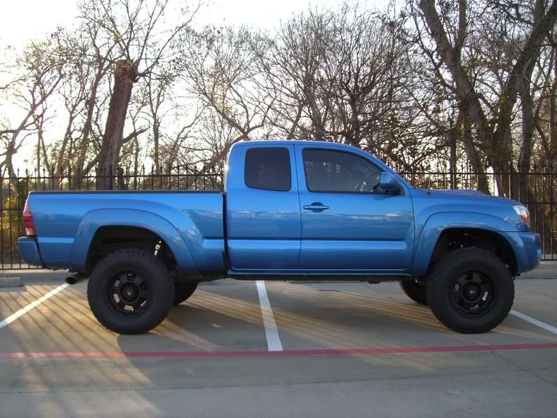

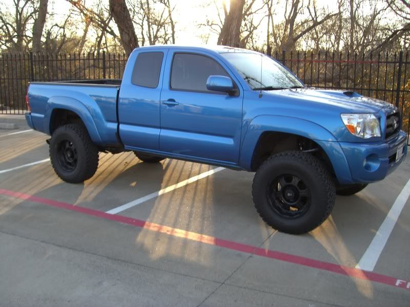

So after a few mods my truck is done
884's up front on 5100's
TC UCA's
TSB and AAL
5125's on the rear
285/70/17's
Originally thought it was not taller than the 5100's set at 2.5 but after alignment that all changed and it is a full 3" and the taco lean has been minimized to less than 1/8th of an inch

Looks great man,, i thought the 884's only gave you 2.5 lift and the 885's gave you a full 3" of lift. so now im confused i only want 3 inches of lift do the 885's also give you 3 just a little stiffer or what

"done" for now we will see what is next . It is a full 3" with the top plate spacers. The way it drives and rides is perfect. Thanks for all the input and helping me choose my set up!

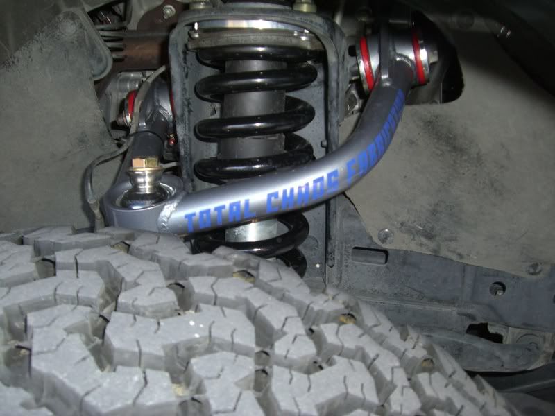

And if you notice I was bored so I put back in the top bolt for the control arms the way they came out it was fairly easy.

The Total Chaos spindles haunt my dreams As does the TRD supercharger
They are both considered a 3" lift. the 884's are only for the reg. and extended cabs. The 885's are for the double cabs. The 885 springs are the same spring rate as the 884's, but the 885's are a little longer. The 885's gave me 3" of lift without the top plate spacers.
