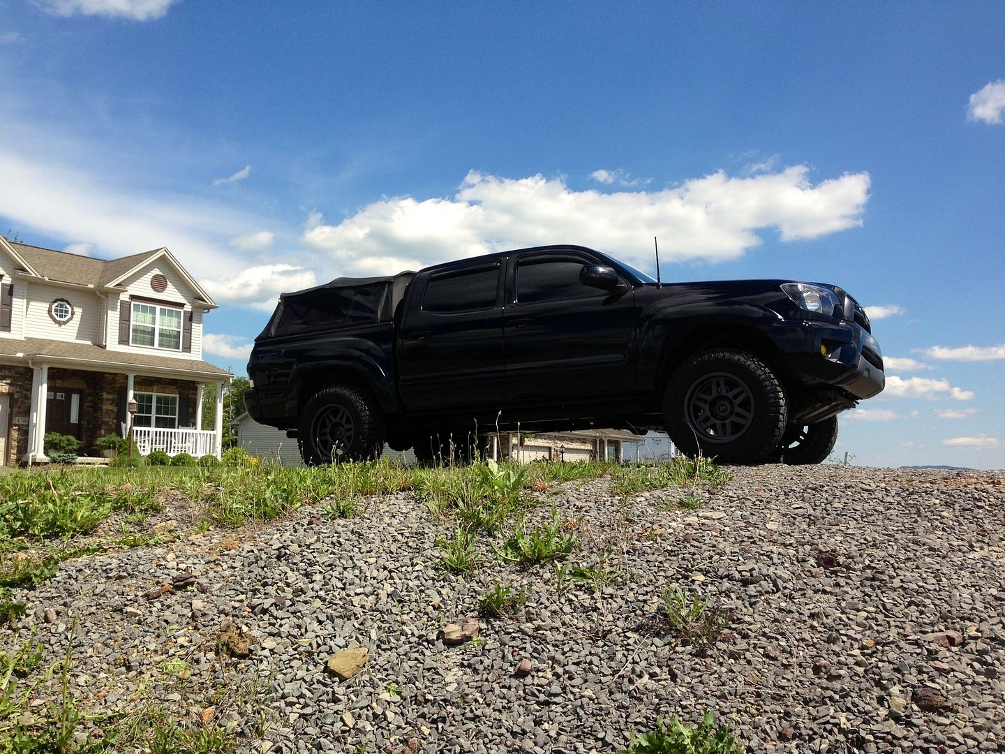

Leveled with 5100s. Nose high 1in block to level?
Front is 5100s set at 1.75 with toytec 1/4 spacer on drivers side. Rear is stock 4 leaf (including helper) with 5100 shocks. It's a little nose high. Was thinking about the toytec 1 inch block for rear. This
http://www.toyteclifts.com/index.php...mart&Itemid=72
Is that a good idea? Should I do the 1.5? Will I get any vibrations?

i did readylift 1" blocks in the back, have had absolutely zero issues, no vibrations, nothing, feels just like stock.

Personally I would sooner use an aal than insert a block. Why not improve your carrying capacity if you are going to bother working on the rear suspension?

^ he has a point, but I had the same issue and just bought a 1" block from toytec. no issues here

I thought about the AAL but always assumed they would make the ride harsh compares to just a 1in block. Glad to hear the good experience with the blocks. Keep the good replies comin I appreciate it!

Got the 1 in blocks installed today. Very easy to do and the stance is perfect! But now have a slight vibration. Any advice to get rid of it? Only thing I can think of is get some washers and start messing around with spacing down the carrier bearing for the rear driveshaft? Any advice is appreciated!
