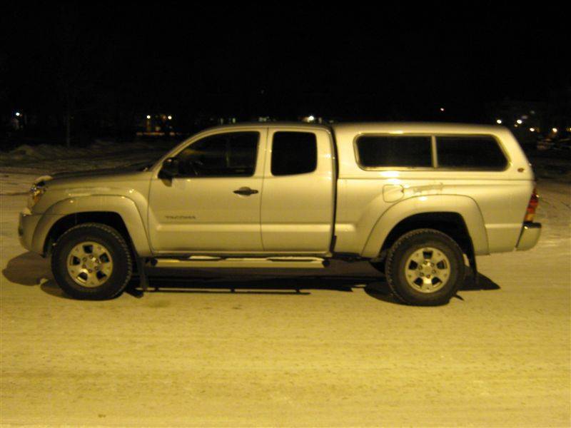

Hi All, Looking for some opinions on where to set my new 5100's. I have a Access Cab 4X4 SR5 with the TSB done and will be putting in 5100's to lift the front a bit. I am running 265/70 Stocks as well.
I would like to go with 1.75, but I have a canopy and a little worried about it being lower in the rear....I like a bit of rake. Also is there any issues with the CV joints/vibration at 1.75? Do I need a dif drop?
I am leaning towards 0.85 because of the canopy weight and liking the rake. Is 0.85 enough of a lift? Those who have it did you notice a visual difference?
Pics would be greatly appreciated, or let me know if you have them in your Gallery and I will take a look. I will toss some pics of mine up once I get it done.
Thanks.
I broke out the jack and did some approx lifts with it.
Stock Height
Approx 0.85 inch Lift:
Approx 1.75 inch Lift:

I set mine at .85 with the rear TSB and still have about the same rake as stock. The rear still looks pretty high but thats how i like it. I have a Dbl cab so you would get more lift from the TSB since yours is an Access cab. But since your adding a topper then it should be about the same rake as mine.
I've noticed with the 5100s at 1.75 and the rear TSB it looks pretty level. Some pictures that I've seen with that setting looks like the front is still slightly higher. So if you still want to achieve some rake I suggest you set your 5100s at .85 and call it a day.

I also prefer a rake over totally level or rear low.
I went 1.75" and it is 2" lower in the front, but I have 280 Lbs of winch and bumper on mine. Towing a trailer is a bit tail low for me, but it works.
If I were going to go with a just a TSB, which I only got 1" from in the rear after settling, I'd set mine at .85".
More rake is better than butt draggin' in my opinion.

After reading my post I feel I was a bit harsh. Even if you didn't read it that way. I didn't mean it to be!
I got within 1/8" of the advertised 1.75" and from what I've read, all the height settings are right on par.
The best part of the 5100's are if you do the install yourself, it only takes about and Hr. to change the height on both sides once you know the drill.
I lost an wee bit more than an inch from the winch in the front. Most measurements you'll find (including mine) are measured from the wheel wells. From my opinion, the rear fender is cut higher on the body line and when they are both at the same height, the truck looks tail low.
Also, when you get an alignment, get the Firestone lifetime alignment package. It costs twice as much, but after the second alignment, it's paid for itself. I get mine done quite a bit because I'm stupid and hit things in the fields I drive. Just FYI, don't mention you have any aftermarket parts, they seem to be a little weary of that.

After looking at the pics you added to the OP, I still like the .85 setting!
the 1.75 is level in the wells, but when I look at the bed line, it looks slightly low and if you tow a trailer, it'll just weight it down more.
Again, thats all just my pref!! I tow a trailer often, as well.

Here's the same but with the Flash which shows a bit more.
Stock with TSB
Sim. 0.85 with TSB
Sim. 1.75 with TSB

I actually have the 4 leaf pack in and blue/yellow bilsteins all around. If you check out the pics with Flash it is more noticable. I think the canopy lowers it a bit in the rear. Plus I had sand bags in all winter so it may have mellowed the rear springs a bit.
I am going to go with the .85 setting, I like to have some rake in the truck. I am not really into jacking it up, just want to make it more balanced.
It looks like the canopy lowered the rear more then I thought. The truck sits pretty level with the .85 setting. Do you have anything in the bed when taking those pictures? The reason I ask is because you may be sitting nose high at the .85 setting with load in the bed, especially when you accelerate. To me the stock setting looks better for your application, considering you like the raked look. I thought I ran across a post in a 5100s thread that you still get a little lift at the stock setting from the 5100s.
