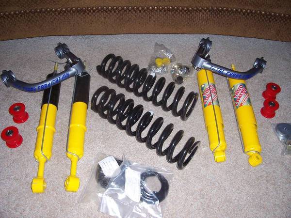

Lift porn, look what showed up today!
Just arrived from Northridge Toyota! Okay, see if this works

Very nice man! Why are you still on here? Go get that mess installed!

Im tellin ya....Those Emu's make some GOOD stuff!!!!
Congrates!

I'm ordering the diff drop and AAL from toytec, not here yet

FWIW, when you go to install the N182's spray some WD40 on the bushing to help them slide in the lower shock mount. They are a tight fit.

Oh....And use Mobil 1 grease on the UCA bushings. Rub alot of grease on the bushings before you install the steel sleave, and put them into the UCA.

Nice setup. I want some OME shocks for mine. I keep hearing nothing but praise about their stuff

Thanks, any advice is greatly appreciated. I will be installing myself and am somewhat mechanically inclined, just in-experienced.

Its pretty easy. The worst is getting the OEM UCA bolt out. Have an extra set of eyes helping you. And make sure you disco the air bag sensors from the body (above the wheel well, under the hood), they are black and yellow wire loom. should be 2 clips on each side. Also, there is a 10mm bolt holding a steel wire loom guide under the battery. Remove it., then, just a little bending, and the UCA bolt should come right out. You may have to chase it with a long 3/8" socket extension.

Do you have to bend something a little...? seems like I read that somewhere.

Yeah. Near the head of the UCA bolt, you need to bend the fender out of the way. Personally, I bend just a little bit, then, useing different size socket extensions, beat the bolt out with a hammer, from the back. You cant use big swings, as there is not alot of space, and on the driver side, up against the firewall, you have 3 fuel lines you need to be caurfull of. It sounds bad, but its easy. In fact....So easy a caveman can do it.........
Sorry..I had to...I just saw it on TV...

HaHa! Sweet, if a caveman can do it I guess I'm in luck. Thanks for the suggestions, I will save this thread for when I install. Gotta go hit the gym real quick, later.....
