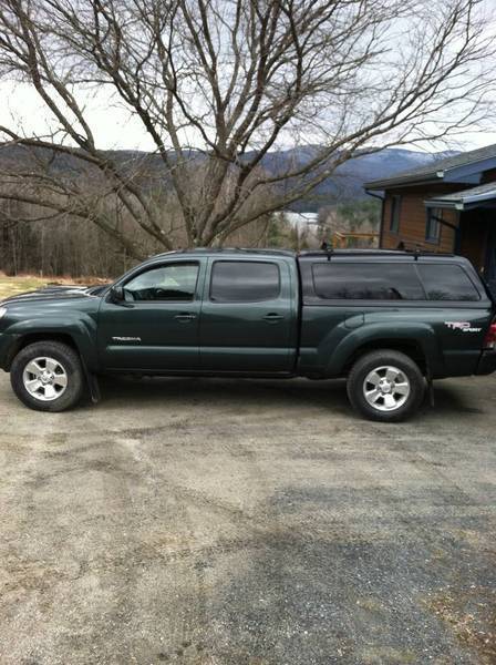

DCLB Icon 3 leaf / 5100s / OME 884s
I decided I wanted to take my DCLB up two inches on a budget.
I bought 884s from DSM because of free shipping $189.99
http://downsouthmotorsports.com/i-68...ner-coils.html
I decided on the Icon 3 Leaf Progressive Add a leaf. I have TSB spring, and left the overload in. Again I ordered from DSM because of free shipping. $214.95
http://downsouthmotorsports.com/i-47...-leaf-kit.html
Wheelers off-road was a ton of help answering questions, so I decided to buy my Bilstiens 5100s and 1/4 spacer (for taco lean) from them. They gave me a great competitive price, just call them.
Fronts
http://wheelersoffroad.com/product/b...trut-set-c477/
Rear
http://wheelersoffroad.com/product/b...ear-shock-set/
UDATE IN POST #30
OME Driveline Carrier Bearing Drop Kit $12.35 + $7.00 shipping
http://wheelersoffroad.com/product/m...ring-drop-kit/
Had vibes 65-70 mph, now they're gone after installing this kit.
Before
After
FTMFW
My hub to fender measurments.
Pre Lift
Front Driver side 20.00 inches
Front Passenger side 20.25
Back Driver side 21.50
Back Passenger side 21.5
Post Lift
Front Driver side 22.25 inches
Front Passenger side 22.00
Back Driver side 23.5 (with overload still in)
Back Passenger side 23.5
I also threw a set of Hankook Dynapro ATMs on in 265/70/17.
My initial thought is that the trucks looks way better. The ride is pleasantly ever so slightly stiffer than stock. It feels great, and I would reccomend it to anyone.
**UPDATE**
Numbers after setteling
Front Drive 22 inches
Front Passenger 22 inches
Rear Driver 23 inches
Rear passenger 23.25 inches

I agree. In order to avoid the look of "bro lean" I figure the rear needs to be about 1 inch higher than the front.

Yes the 5100s are at 0. Its not a good idea to preload OME springs.

All the components were $718.94
Installation was $287.00 with crappy alignment

The shop that did the work charged $287 for everything. It took them about four hours. The assembly was part of that.

I didn't take the overload out, so I would say yes it handles more load. I have a 160 lbs cap, I was towing my 1600 lbs popup with no sag today.
