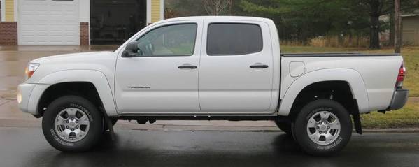

I measured my truckís ride height, before starting. I donít know how much the original springs settled over 140,000 miles but I may stop at my Toyota dealer and measure a new one. Iíd like to feel how much movement is in a new driveline carrier bearing too, but more on that latter. The new springs increased my ride height by a little over 2Ē. General Spring had explained, when I asked them about the bushings, that the shocks were actually for 2Ē to 3Ē lifts, not the less than 2Ē ones Iíd ordered. Their experience with the springs led them to be proactive on this even though their web info says the springs will raise a truck about 1ĺĒ. My results explained why their decision was a good call. I had the front shocks installed by a shop that also did the new tires and aligned my truck. I didnít do a final ride height measurement after the front shocks were install but I used the ďadd 1.75Ē setting on the front Bilsteins.

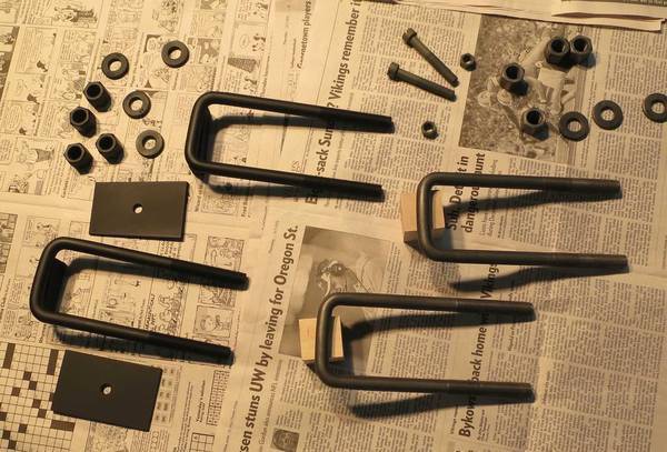

Having to take stuff apart, again, to add the wedges/shims I took the opportunity to paint the u-bolt hardware. More an experiment than anything, Iím curious to see how well a bath in phosphorus metal prep, Rustoleum etching primer and Rustoleum mat black automotive paint will hold up under there.

Iím sure my truck is not perfect but the 40sį temps we were gifted this past December weekend will be the last tempts for a long time that Iíll do work in my garage just to try for perfection. Itís a truck. With the wedges in and my front end up 1ĺĒ, my final rear end ride height increase turned out to be about 2ĺĒ. When I restored an old car it took a year to stop seeing the flaws and to be able to view the completed job. I hope by next spring Iíll be done wondering how much difference there would be with a nice fresh firm drive line center bearing. Hmmmm.
