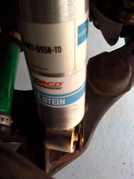

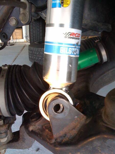

So I finally found someone with a spring compressor to swap my 5100's (I was skeched out by all the injuries you guys detailed with the diy compressors). Pep Boys swapped both out for $42. I get home, and eagerly install the drivers side strut and it goes on great. Then I get to the passenger side and find that the bottom shock is off just slightly. So me being the brainiac that I am force the shock into the lca only to find that it still won't line up and now is suck. My question is there any way to spin the shock without removing it?

Stick a 6" long (or longer) 3/8" socket extension in the lower shock mount "eye", and turn the shock until it lines up. It will be fine.

Easy fix. Get a 1/4" extension (6 inches or so) or a heavy duty screw driver and run it through the hole for the bolt and into the hole in the bushing. Then pry . . . you may also want to have somebody push down on the upper control arm.
