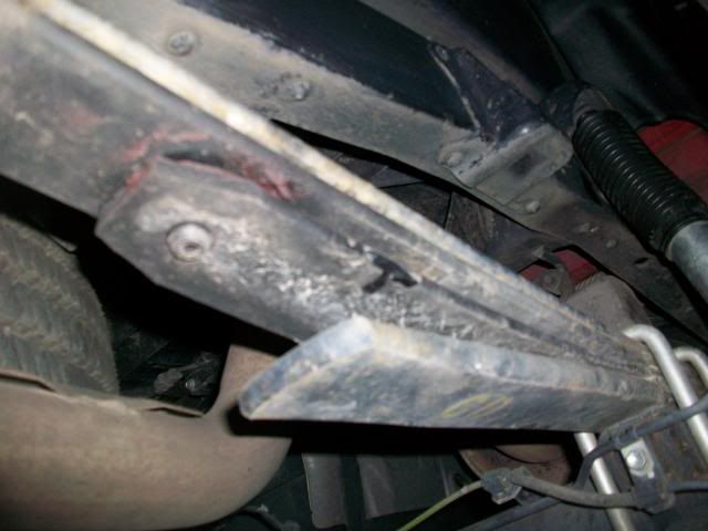

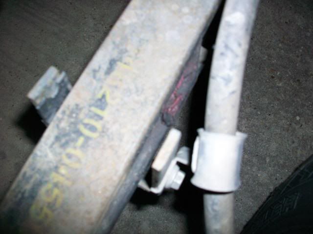

Can someone tell me why my AAL is do this....
Well yesterday i rotated my tires and cleaned behind my rims...when i was doing this i seen on the passager side leaf spring my AAL was not aline no more like when i installed it. I used a hammer to get it back aline but today its back out again. its only on the passager side.Why is it like the, anyone else have with problem? here some pics if yall can tell.....

Check your u bolts for loose nuts.
i did anything is tight...

mine is like that too!! noo idea why....

I know this isn't the answer you seek but on my old hilux prerunner, the aal stuck out like that or a bit more even, no matter what with the ubolts. Drove it like that for years, jumping stuff, climbing curbs, offroading, you name it, without any issues. OK, maybe it'll turn out to be an answer....I forgot. What I did was get these leaf spring clamps for them to keep them in line. They attached to the rear of the leafpack. Maybe something like that could help you out.

Maybe the leaf/shackle bushing wear letting them get out of line??? new shackle/ rear leaf bushings didn't help mine but maybe the front ones needed to be replaced too. Or possible axle wrap action/torque making them get crooked?

u check the tightness of the center pins?
no not yet

thanks yall. yalll think it will hurt anything until i can get to it???
