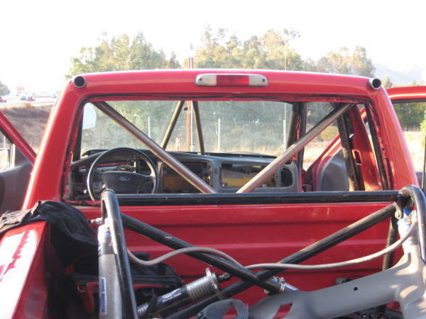

Bolt in shock hoops.
I really want to up grade my rear suspension to the All Pro 1.5" leaf pack. which im probably going to buy in the next week or so. But my question is does anyone make bolt in bed shock hoops for our 2nd gen 6-lugs. I really what to run some 14" 2.5 shocks for the rear. I know Dixon Brothers makes one for ford ranger which my buddy has.
This is my friends ranger with Dixon Brothers shock hoops.
Sorry for the bad pic i know it doesn't have the whole thing in focus but its all i got at the time.

i have never seen one. call hassim at engage and see about a cage, his price is resonable, are you going spring under.

You could contact TTORA member Mpower (Mike).
He is running a simple bedcage with King 12's. Im having a bedcage built this week that looks like his but with 14s like what you want. Its all welded on though not bolt-in.
Here are pics of his setup. He made the bedbar removeable.
since i dont have the cash for the spring under kit, i just want something simple so i could pull somewhere around 14" of travel with a over axle spring.

Thanks 06HAOLE ill try that.
Yea i dont really care if its weld on or bolt on i would prefer to have weld on i hate always looking to see if every bolt is tight.

weld on will most likely be cheaper, will the leaf's go that high before hitting the frame. what about bump stops.
Not really sure if i know what you mean if the leafs go high enough, like my friend is running them with just billy 5100 in the stock mounting position and he hits the factory bump stops on the frame. And i will be running air bumps too.

just wasn't sure how far up the leafs and axle will let you go up, but air bumps will help alot. hate the stock bumps and those are gone next.
Ok yea i get it.
now im wondering if ill even be able to get the allpro pack to use the 14"es of shock maybe should i consider 12"

Im using 3" All Pro springs with King 2.5x14" smooth body shocks with King 2.0x4" travel bumps.
The All Pro pack will take between 12-14" of the 14" King shock. Thats why I went with the 14" over the 12" shock.
If you wait a few days you can compare/critique my setup when I pick it up on Friday.

i would get the leaf pack then have someone do the cage then buy the shocks. you would just have to talk to someone before buying the shocks. i would think you will have to move the shock mount on the axle so you can run them to the cage.

Yea ur right you really cant tell untill i start building it. Yea im thinking i might have my friend build it since i really want a removable support bar so i can fit 2 dirtbikes still. I totally for got about him, i was just working with him on a cabcage.
You definitely have to move the lower shock mounts. I cut the upper/lower/ shockmounts and bumpstops off. Its all new from there. The bumps are going to be welded in as well as the strike pad on the axle.
yea im planning on having some beefier one welded on also. just kinda curious if you dont mind how much is the shock hoops running u, mines shocks and leaf pack.
also r u boxing in any of the frame for more strength?
