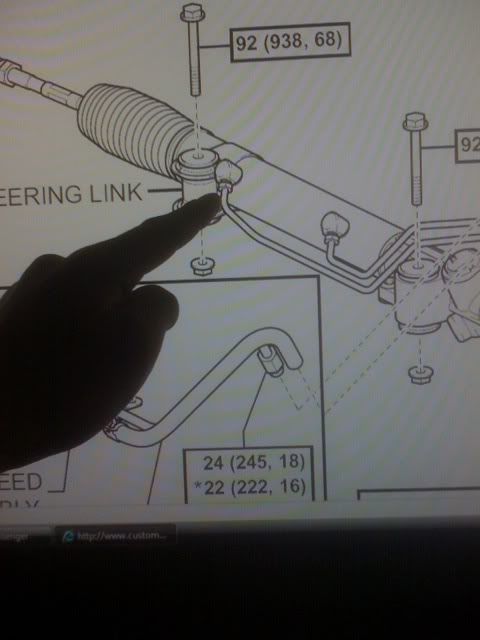

This is where the leak is coming from. Leaking from the back of the nut. Could it be just an o-ring issue or will the line need to be replaced? If that is the case what is the technical term for this line?

I believe they call that the "right pressure tube", at least according to the parts list I have for 1st gens. Doubt they'd name it something different for 2nd gens since it looks the same and goes in the same location.
No clue what they use to seal those with, if its just an o-ring, or some type of sealant.

should be a flare nut,get a wrench and tighten it up
