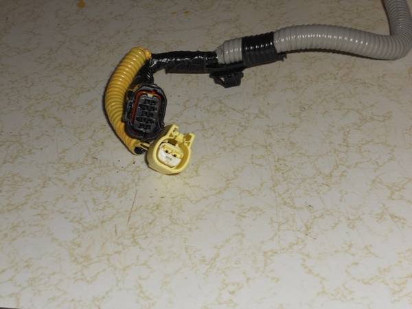

Drivers Bench floor harness-2 + yellow seat airbag plug; (bench specific)
Passenger Bench floor harness-1 + yellow seat airbag plug; (bench specific)
Passenger bucket floor harness-1 ; (bucket specific)

Complete floor harness-1 Assy should look like this; Grey 6-pin plug to Passenger bucket occupant detection computer, Yellow Plug to airbag module, large grey plug goes into passenger kick panel (Not shown; seatbelt pre-tensioner plug and door switch wire).
Close-up of the three large plug ends of floor harness-1;
Passenger floor harness-1 seatbelt pre-tensioner plug;
Passenger floor harness-1 Door jam switch connector;
