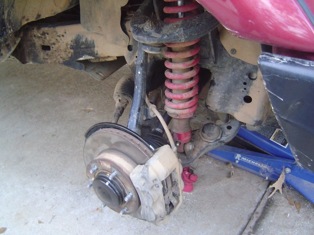

    Remove tire/wheel/skid plate
    Trust me on the skidplate – ESPECIALLY if you have aftermarket skids
    Usually I like to place the tire underneath the front of the truck so that God-forbid the jack/jackstands fail the truck doesn’t crash completely to earth. I chose NOT to do this during this axle change. I also did not use jackstands as I was unable to locate mine. I did however use 2 jacks for that just-in-case factor

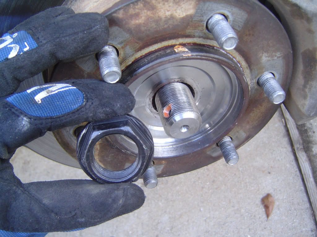

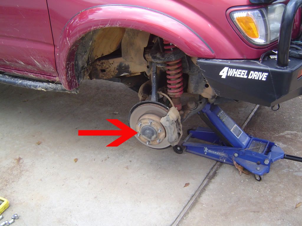

    Once you’ve removed the wheel, you’ll see a black metal cap at the center of the hub
    You’ll want to remove this carefully so as not to booger up the edge too badly because we’re going to reuse this. The best way to remove it is with a chisel or sharp screwdriver. I used a small chisel and a rubber mallet and it popped right off

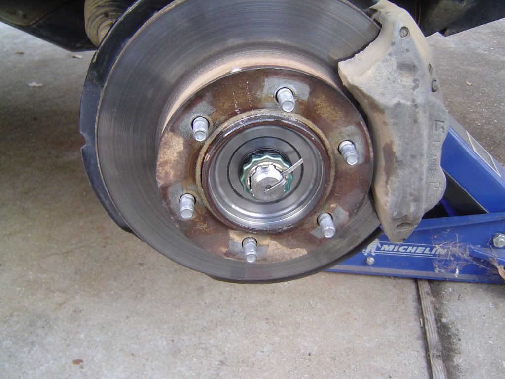

    Once you’ve removed the black dust cap from the hub assembly, you’ll see a large nut and a cotter pit and quite possibly a cotter pin lock? Im actually not sure what you call it but it’s the green thing in my picture
    Remove the cotter pin and cotter pin lock and then using a 36mm socket and a breaker bar or air gun (what I prefer) remove the large nut. This can get a bit tricky as the hub will want to spin while you unscrew the nut. It’s handy to have a 2nd pair of hands to help you but I wasn’t so fortunate today. I angled a screwdriver between 2 of the studs and braced the hub from spinning while removing the nut with the air gun.

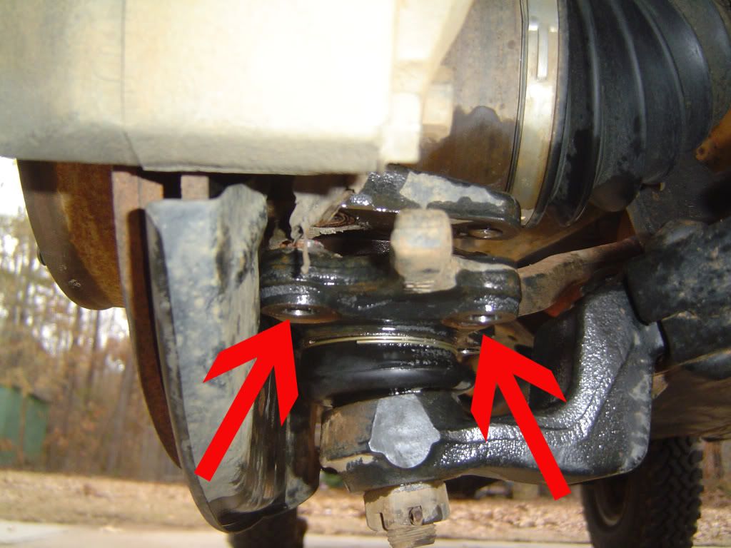

    Once you’ve removed the cotter pin and nut, move around to the backside of the hub assembly and disconnect the 4 screws holding the spindle to the lower ball joint. There are 2 at the front and 2 at the back. IIRC this is a 12mm socket.
    In my picture, I’ve already removed the bolts but the arrows are pointing to where they were.

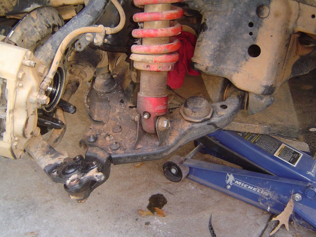

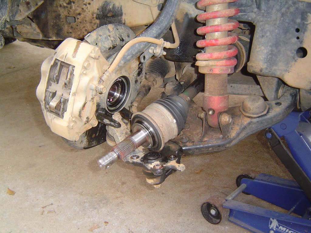

    Step 6
    Pull the spindle out and separate it from the cv axle. It should slide out fairly easily but you may have to bump it slightly to get it to separate. Swing the spindle around to the backside towards the cab of the truck.
