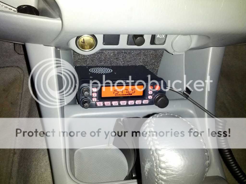

Be careful though when you cut that out. Right behind there is your air bag control module. Very very dangerous area to be working in. Above the module on the passenger side is a large piece if thick black plastic the must be removed for a radio to fit. Its OK to cut that off, it does nothing. But again, be careful not to hurt the module when cutting the plastic trim.
Then, when cutting a hole for the radio to slide in, you can't cut the bottom for it to slide right down otherwise the radio will just hit the floor and/of module. You can't cut the too because then it'll hit the trim behind it and you'll end up cutting off the clips that hold the center console on. The cutout for the radio has to be right in the middle of the panel. Very hard to get right. I messed mine up good, but fixed it by making a carpeted panel to go around it (trim panel).
I've done several now so I have it down but its hard if its your first one. Manually tranny is way easier (as seen in Manwithoutaplan picture of his ICOM) but auto is the difficult one cuz you have way more room. I'll post some more pics to shoe you where to cut

Here is mine, you can kinda see what I mean by cutting not too low and not too high. It has to be cut right in the bend in the panel. Yeasu 7900
This is the yeasu 8900 in a manual. Still requires it to be in the middle. Same with an ICOM even though the are way more thick.
