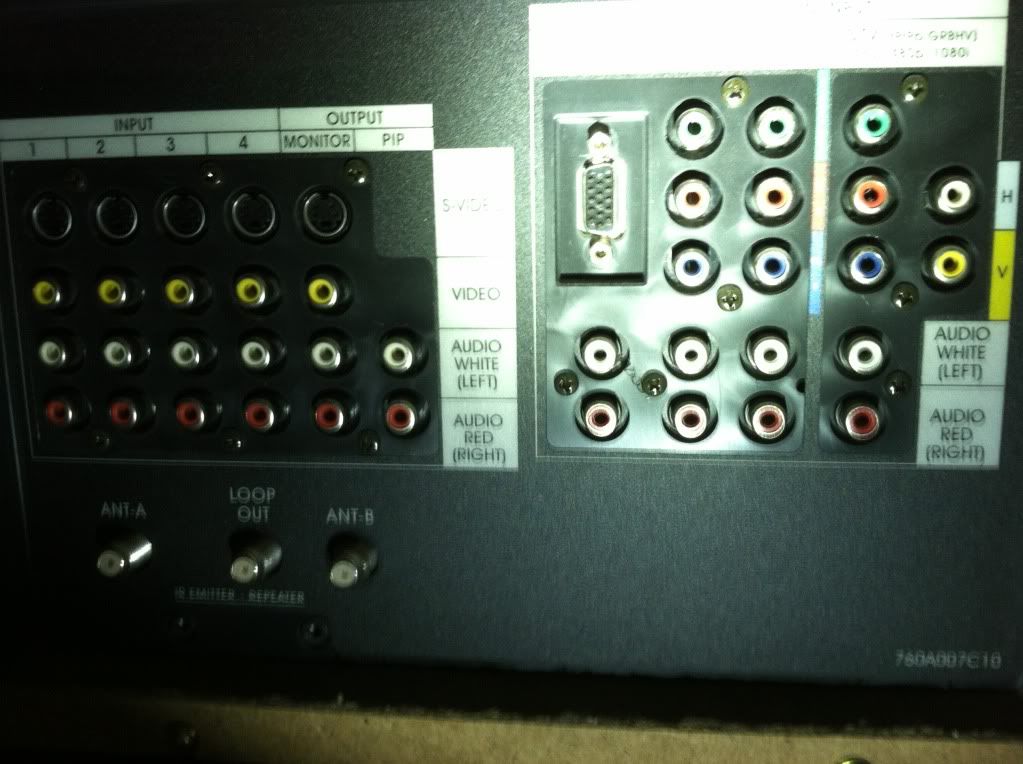

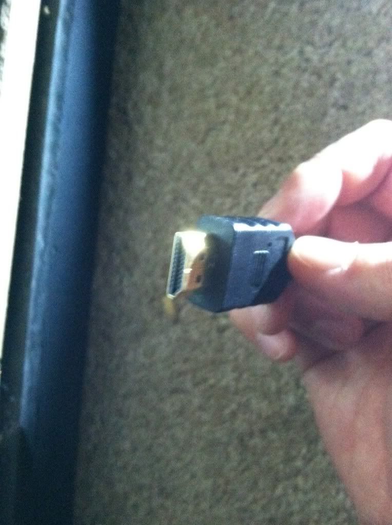

Recently got the chance to pick up a Mitsubishi WS-65869 65" rear projection HDTV for free.. although it has some problems I first need to solve the simplest one... First problem is that I think I need an adapter because I see no HDMI cable socket. The HDMI cable socket is coming from my cable box... I am not sure what I will need, here are the pictures of the HDMI socket coming from the cable box, and the TV outputs.

Easiest would be to use something other than HDMI from your cable box. Does it have component out? Otherwise, you would need something to covert the digital HDMI signal to an analog signal. Then there's HDCP, where legally some or all of the signal may be stripped of certain content (ie. 5.1 surround may be dropped to 2 channel audio). Best way to go is get a newer TV, or a receiver than can convert the signal for you.

As stated above your best bet would be to use the component out on your cable box. The TV is too old. It does not have a digital input for HDMI or even DVI. Good thing is the TV was free.
