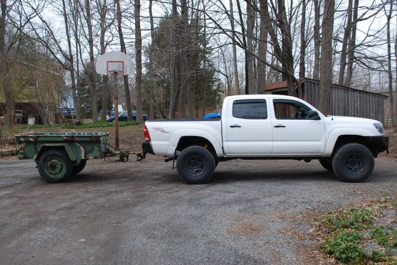

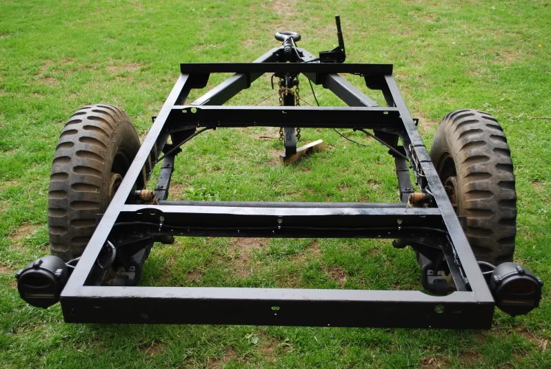

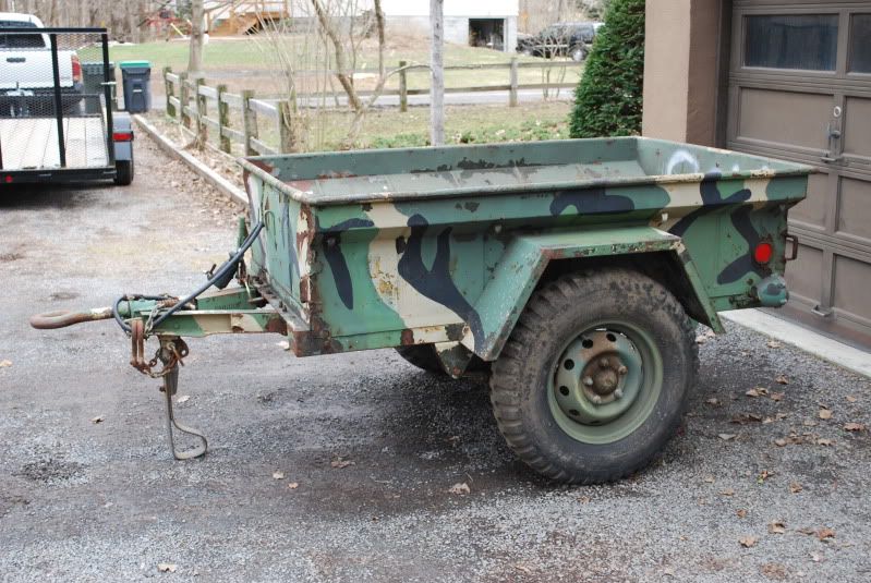

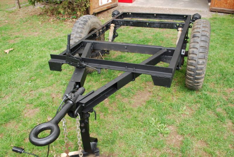

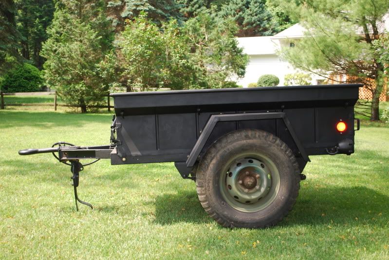

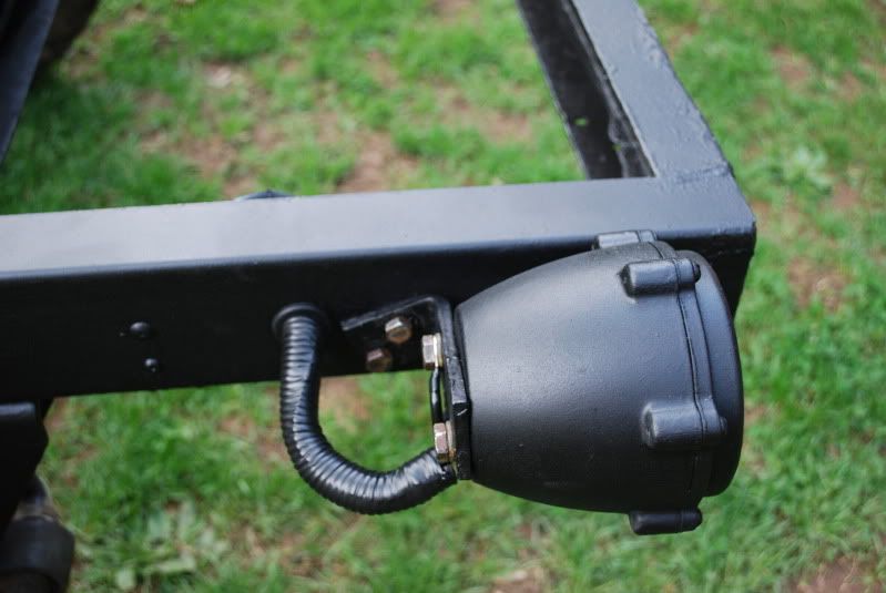

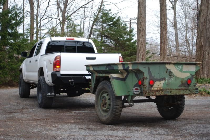

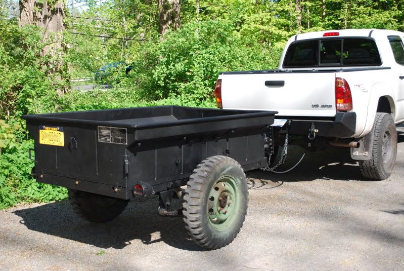

    I bought a solid 1967 M416 military trailer this winter to tow behind my Tacoma. I pulled the tub off the frame and sandblasted everything. Then everything got a coating of POR15 and then I sprayed everything with truck bed coating. Also rewired lights and switched them over to 12v. Im pretty happy with the finished product. Only thing I might still do is the spring over. :D
    The day I got it home
    Few pics during build
    Just missing fenders
    Done

    $500 for the trailer + the 100 miles each way to go get it. $50 for can of POR15. Not sure the cost for all the new Grade8 hardware and other odds and ends. Maybe $50-$75. I saved every receipt for everything I bought for it. (I do that with all my vehicles I build :)) I just havent calculated total cost yet. All the sandblasting was the most time consuming and shitty part of it. I would guess maybe around $700 total cost.
    Yeah. Just been lazy.
    $500 and check out this info plate for dimensions. :thumbsup:

    How old are those tires? Going to upgrade those? Old trailer tires make me nervous if any weight is on them.

    They aren't originals. They are a little dry looking in a few spots. They will be getting peplaced also when I find a deal on a set.
