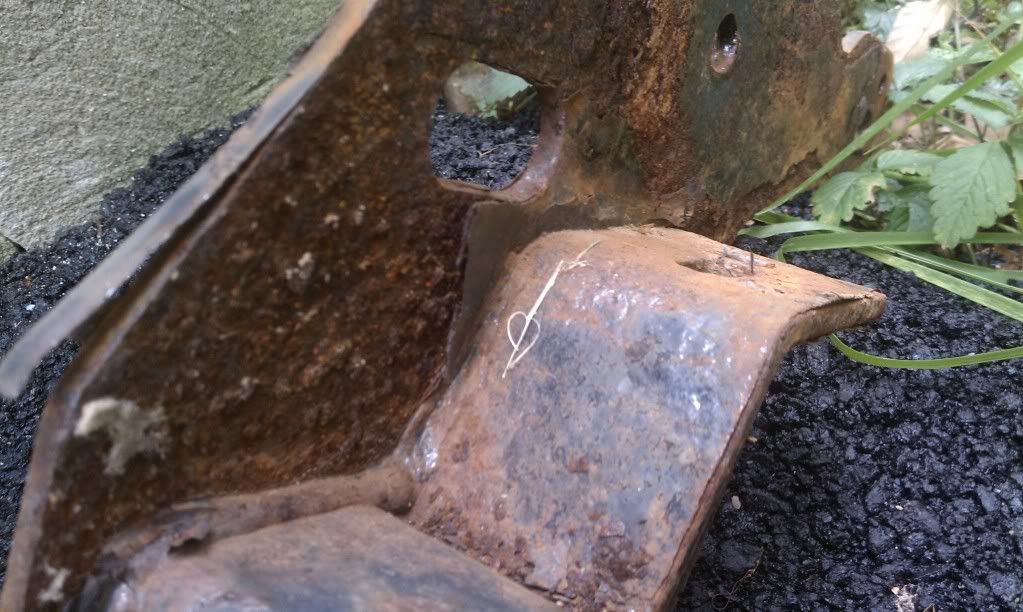

    An aftermarket hitch came with my 2003 V6 Tacoma but it looks pretty weathered. I took it off today to get a better look. Most of the paint has separated and it is covered in varying degrees of rust. I'm wondering if I could just sandblast it and keep using it or if I should just buy a new one. I'm about to move my girlfriend with a 6x12 Uhaul trailer. Anyone have advice to offer? Thanks
    Inside mounting bracket:
    Heres what it looked like after I went at it with a wire brush:

    looks fine to me. Just get that rust off and treat it with some kind of paint over rust product to prevent it from getting worse.

    x2, the rust seems to be more on the surface rather than pitting in and rusting through.

    Pick up a wire wheel and throw it in a drill. A lot faster than a brush. :D

    Sheesh, I would sandblast that. As long as the welds and thickness are good, should be OK.

    I did use a drill to blast off what I could. I'm thinking of going the sandblasting route. As for the frame, its seen better days for sure but its not nearly as bad as the hitch. Right before I bought it the truck went to the dealership for the rust issue that affects 1st gens. It passed their inspection and they put a fresh coat of undercoating on. Over 160k miles so far and no signs of slowing down.

    x2 on picking up a wire wheel!

    We have a local place that does headstones and they sand blast whatever you bring them. Usually $40 for stuff that will keep them busy for about 1/2 an hour. Always much easier especially with the inside corners.
