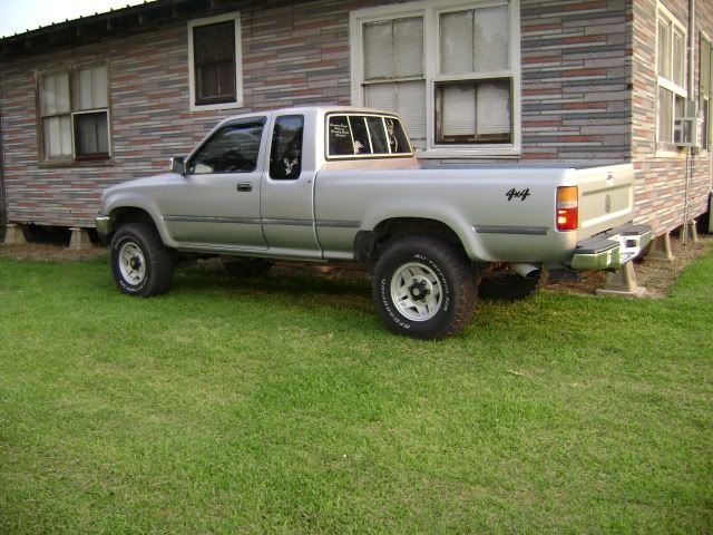

I need some ideas on what to do with my 1990 Yota.
I have a 1990 extended cab 4x4. The 3.0 with an auto trans. I would like to know what engine and trans to have in it for wheeling, because this motor is incredibly under powered. I am also interested in a SAS and those of you with the knowledge to let me know what parts I will need to start gathering up to make all of this possible.
I've had the truck for a while and intended to use it as a work truck but the fuel economy and power is just horrible. So its been sitting on the side of my house. Drop me some ideas.

it looks pretty clean... it should be a pretty fun project!
Good Luck!
