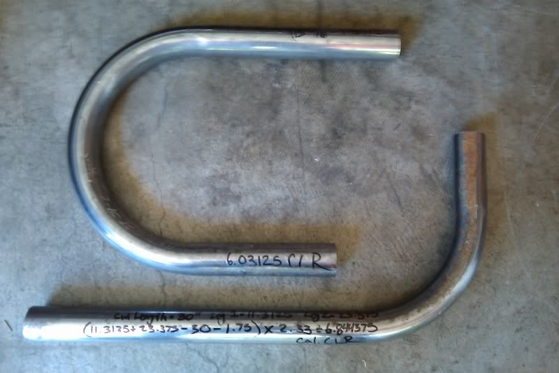

Finally finished building the bender and bending the pieces to calibrate the software for the die:
The calibration pieces:

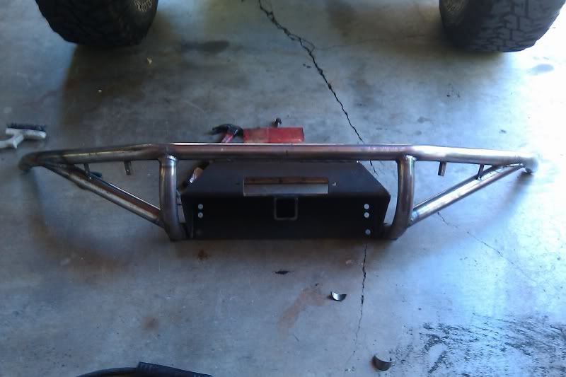

Main bar and center supports tacked up:
One side support in place:
Left side support in place as well as some tabs for the stock turn indicators:
Turn indicator in place:
All tacked up and ready for finish welding:
