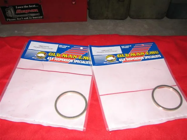

lol i'm sorry for asking so many questions but whats the front adjustable trim package?

Its a "Trim Packer". It adds a bit of preload to the driver side spring to account for the extra weight from the fuel tank, battery, driver, etc.,

Chris, you are the man, on top of everything like white on rice. Here is a picture of a trim packer.

where does the trim packer go?
Under the spring pearch on the driver side shock.

spring perch = lip on strut that holds the lower plate?

The spring pearch is the black "Cup" in which the spring resides. So....You have the shock, and the shock has the "lip" that holds the pearch. The Trim Packer goes inbetween the "lip" and the "Pearch".
