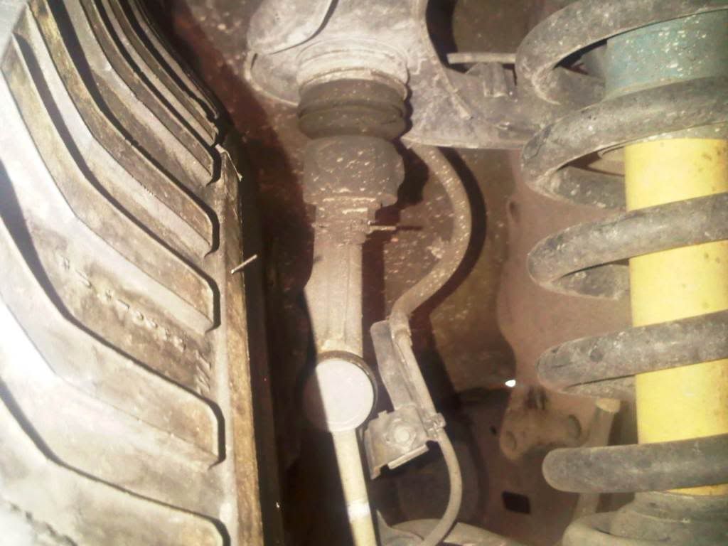

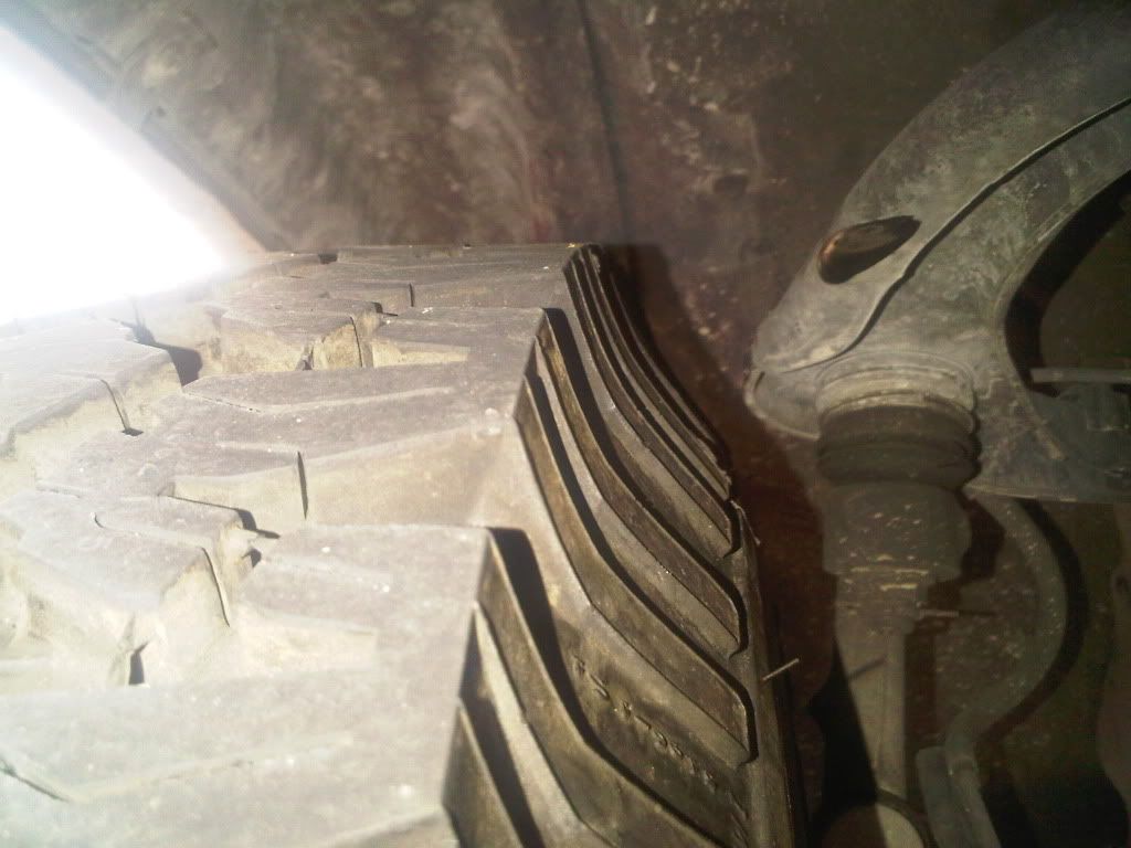

    All:
    Here are the best shots to display UCA and Inner Body Component distances.
    No issues. I believe the same as Ulysess - No 4-wheeling - No problem.

    Well after another 2 weeks I have discovered the front tires are slightly rubbing against the control arm at full lock. Not enough to cause a problem. Just wanted to update people whom asked. Did not see it until I looked and found the paint rubbed off. No drive issues though.

    if you are catching the uca on the tire during normal driving you are going to destroy that joint if you wheel it. And "no rubbing" on the highway is not "no rubbing" during flex... You may want to look into a minor lift or risk tearing stuff up if you offroad jmo..

    I agree this rub is not optimal. But not major (only the outer tip of tire tread is making contact). 4 wheeling would definitely be an issue with flex. However, I do not want to continue long-term with the rub.
    It is only the darn tip of the tire tread. I need to search the forum to see if lift kit raises the UCA???
